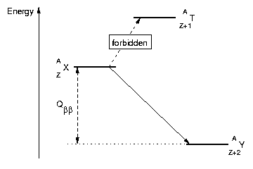

This one is rather trivial. In some rare cases, there is simply no favorable simple beta decay. For the decay to release energy, you need to turn 2 neutrons into 2 protons. This is illustrated in the following plot from NEMO site :
Simple beta decay would be Z -> Z+1 (which is not possible).
Only double beta is possible Z -> Z+2
