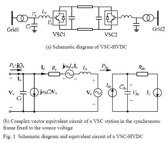

DQ Reference Frame in VSC Station: Fig. 1(b)
In summary, the vector-based equivalent circuit for each VSC station in the synchronous dq reference frame, as shown in Fig. 1(b), is used to describe the alternating current (AC) system. The dq reference frame is chosen to 'freeze' the axis and is synchronous with the supply frequency, but in this VSC system with two different frequencies, one side's phasors will rotate slowly around the reference axes of the other side if they are not synchronized.

Each VSC station has the same configuration, and its vectorbased equivalent circuit in the synchronous dq reference frame is shown in Fig. 1(b).
Could someone please explain me what doe "dq reference frame" mean?
Is it not just talking in terms of phasors? When you use phasors for AC descriptions, you choose to 'freeze' the axis, synchronous with the supply frequency. This VSC system involves two different frequencies (?) so one side's phasors will rotate slowly around the reference axes of the other side, if they are not synchronised.

Are you familiar with Phasors? (Not the Star Trek ones!)
The "dq reference frame" refers to a specific coordinate system used in vector-based circuit analysis. In this context, it is used to represent the configuration of a VSC (voltage source converter) station, which is a type of power electronic device used in electrical systems. The dq reference frame is a mathematical tool that simplifies the analysis of the circuit by rotating the coordinates to align with the voltage and current vectors. This allows for easier calculation of power and other parameters in the circuit. The figure provided (Fig. 1(b)) shows the vector-based equivalent circuit in this reference frame for each VSC station, which helps to better understand and analyze the behavior of the station in the system.
