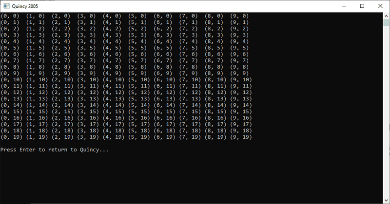

Today, and for quite some time now, "drawing" is done at the pixel level, not with characters. Most compilers include some graphics functions and I think all IDE's include a basic graphics library. Folks who want more complicated drawings usually use an extended graphics library.
Don't be alarmed: I'm showing nothing new and just dabbling on what's given above. The OP has already posted their code. I'm proposing you think of your nested for loop (a for loop inside of a for loop) as a big coordinate system just like in your mathematics class. Then you can use your if function as a test: Does this cell (x, y) intersect with my equations for a square or circle? Would this help? Maybe you can turn this into a more achievable math problem than a programming problem ;)
Code:
#include<stdio.h>
int main()
    int Height = 20, Length = 10;
    for(int y=0; y<Height; y++)
        for(int x=0; x<Length; x++)
            printf("(%d, %d)\t", x, y);
            // Should a print a symbol here?
            /* if(squareTest)  // Use math equations to determine if cell intersect with square
             *         printf("-");
             * if(circleTest)  // Use math equations to determine if cell intersects with a circle
             *        printf("*");
        // New row
        printf("\n");
    return 0;
You can also start your loops from a negative number and loop through -0.5*Length to 0.5*Length if you don't want to deal with any offsets from equations you might be more comfortable with.
Since it's discrete you might have to do some type of tolerance like IF() it's within some tolerance that it prints so that you don't have to worry about decimal problems. Tolerance can be described with the greater than or less than equations like is it within if(minimum < test value < maximum)

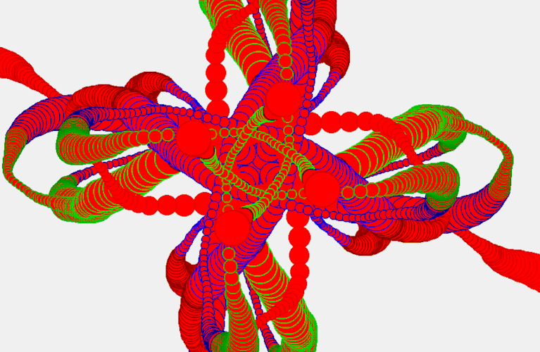

Example (a program I wrote years ago for my kids). This produces an infinite variety of patterns by selecting various options and then moving the mouse around.
Likes berkeman
