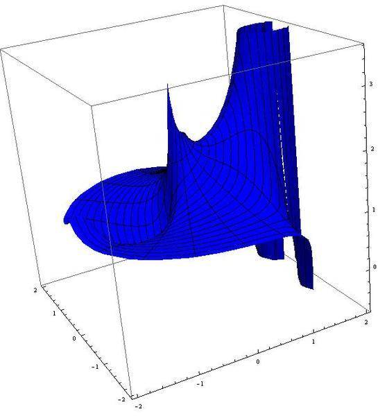

Second Test:
Plot the real or imaginary principle sheet of the function and the series expression for 35 terms in the annular disc [itex]0.1<r<2[/itex]. Color one red, the other blue. Superimpose them onto one another. The results are below and so identical that I cannot distinguish between the two plots on top of one another. Usually when this test is run and the results differ, the plot will be a patch-work of red and blue. In this case, one plot completely covers the other plot.
