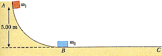

Consider a frictionless track ABC as shown in Figure P8.23. A block of mass m1 = 8.00 kg is released from A. It makes a head-on elastic collision at B with a block having a mass of m2 = 14.0 kg that is initially at rest. Calculate the maximum height to which m1 rises after the collision.
To find the initial velocity of mass 1 right before the collision:
Ug = KE
mgh = .5mv2
gh = .5v2
(9.8)(5) = .5v2
v = 9.9
Find the final velocity of mass 1 right after the collision:
vf1 = (m1-m2/m1+m2)vi1
vf1 = (8-14/8+14)(9.9)
vf1 = -2.7
Find the height at which the mass will reach with the initial velocity 2.7:
Wnet = [tex]\Delta[/tex]KE
KE - Ug = [tex]\Delta[/tex]KE
.5mv2 - mgh = .5mvf2 - .5mvi2
.5vi2- gh = .5vf2 - .5vi2
.5(2.7) - (9.8)h = .5(0)2 - .5(2.7)2
h = .7438
Final answer is incorrect. Any ideas?
Requesting assistance!
If you know the initial velocity, rather than evaluating the hight using the net work, try just changing kinetic energy to potential energy in the same way that you converted them at the beginning.
In terms of total work, you will find that your final answer turns out to be double the answer using this method.
I hope this helps a little.
