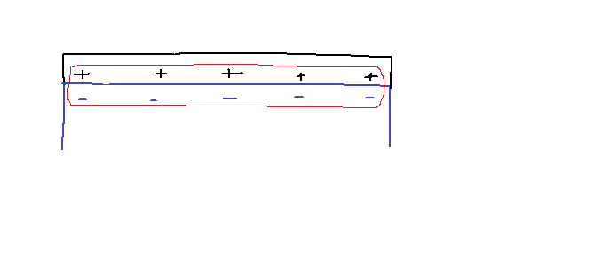

For the surface charge, we must compute the bound surface charges on the dielectric first.
Gauss's Law reads:
[tex]\epsilon_0 EA = Q - Q_b[/tex]
[tex]\epsilon_0 EA = \sigma A - A\vec P . \hat n[/tex]
[tex]\epsilon_0 E = \sigma - \epsilon_0 (\epsilon_r -1)E[/tex]
[tex]\sigma = \epsilon_0 \epsilon_r E[/tex]
Or in other words, ##E = \frac{\sigma}{\epsilon_0\epsilon_r}##, the electric field is reduced by a factor of ##\epsilon_r## due to the presence of the dielectric's polarized field.
Electric field at d is ##\frac{2}{3}\frac{\rho_0}{\epsilon_0\epsilon_r} d^3##.
Thus, ##\sigma = \frac{2}{3}\rho_0 d^3##.
I get essentially the same result except for some signs. I get a positive amount of bound surface charge at the surface of the dielectric (due to the polarization of the medium). I get a negative surface charge density on the surface of the metal plate.
If I pick a Gaussian pill box as you did, I would write Gauss' law as
##-\epsilon_0 E_x A = Q_{tot} = Q + Q_b = \sigma A + P_x A = \sigma A +\epsilon_0(\epsilon_r - 1)E_x##
