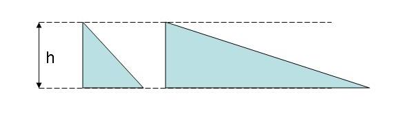

You may not believe it, but you already know about potential difference quite a bit, if you've already taken basic kinematics.
Look at the picture below of two inclined planes of equal height.
Now, what do you think is the difference in potential energy when an object moves, say, from the top of the inclined plane to the bottom? Does the fact that one has a longer ramp than the other makes a difference at all?
Go back to your question. If you have 100 Ohm resistor that is either 1 cm, or 100 meters, connected to the same potential difference, do you think there will be a difference?

You beat me to it. I was composing a long rambling explanation but you have said it all. If you needed to drive a car up those two slopes (aka same PD) as fast as you could (max power), you would just use different gears but would arrive at the top in more or less the same time. The force from the wheels (aka Field) would be different in each case but that would be irrelevant.
I do need to correct that piece of idiocy in my last post. Of course, increasing the length of the resistor Decreases the field (the Volts per Metre). I should read through things more carefully before pressing the go button.

It's strange that students seem to be quite happy about rolling cars down slopes but the electron volt, as a concept seems to get 'em confused.
So a longer resistor of the same resistance doesn't produce a stronger e field in fact the opposite a weaker one if measured in a single point in the resistor compared to that of the shorter resistor, but since the distance is longer the overall field exerted force on charge is the same, because a given PD has only a given amount of force which cannot get bigger by itself right ?It kinda seemed like that, following my inner logic which is not always the best one ofcourse.
Well according to what @Zapperz said yesterday in his post , there should be no overall difference in the electric field in a resistor of given ohms say 100 and given PD , the only reason that a shorter resistor could have a higher field strength in a given point along it's way than a longer one is because the same field due to the same resistance and same PD now has to occupy a smaller/shorter space , this should be correct? I agree to what Zapper said and aslo to what you sophie said it;'s just that I wanted to know the reason behind this. Comparing this to the inclined lines of Zappers post and the car running uphil to what you Sophie said I can conclude that even though the energy used by the car to get to the same potential hegith is the same in both cases , in a longer climb the energy used per a unit length is smaller due to the unit length being longer itself right? the opverall energy is the same but the energy per unit or the field per given point is stronger, my inner voice tells me I should be correct about this one. I hope so.
Perhaps you should tell your "inner voice" to shut up and to give your brain a chance at this problem.
