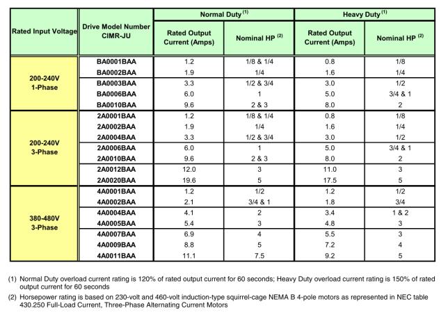

Take this image for example. It has rated drive current and horsepower outputs.
So if continuous torque is required (Heavy Duty), the power output goes down and so does the output current. I understand if there is more strain on the motor, then of course the power outputted will go down. Quite simply, not as much work is being done. However, why is the current going down? Common sense tells me that if there is a heavy load to keep "torque-ing", there should be more current required, not less.
This normal duty - heavy duty stuff is confusing the hell out of me.
A Vfd runs a motor via pulse width modulation schemes, There are different schemes to handle torque applications. Volt vs hertx vfd's have low break away torque for example as compared to a flux control vfd. In essence the scheme is a predictive current controller. If you are using any scheme other than volts vs hertz do not hook up more than one motor to that vfd. It will misinterpret the current requirement and blow the vfd. Though not right away.
