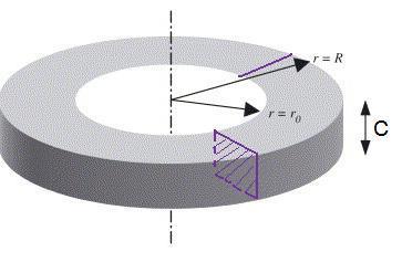

There is a bent bar with inner radius A and outer radius B and thickness C. Bar is bent from the x-axis to the y-axis in a quart circle.
1) If the bottom of the bar has potential 0 and the top has potential Vo, find Resistivity.
2) If the inner circle had potential 0 and the outer circle had potential Vo, find the Resistivity.
3) If one end has potential 0 and the other has potential Vo, find Resistivity.
Ohm's Law, J = σE
I attempted to find the volume of the bar, which I found to be (b^2 - a^2)*c*(pi/8). I think I now need to find an electric field, but would like a bump in a correct direction.

My best guess for the geometry of the OP question is that the bent rod is a section of a square cross-section torus, as shown in the picture but consisting of just a quarter of the full torus (between the two purple cross sections). At least that agrees within a factor of 2 with the OP's volume expression. Radius A and B of OP correspond to r0 and R in the picture.
If so, would finding R be straightforward for the following two cases?
(1) R between top and bottom
(2) R between inner radius ro and outer radius R
but not straightforward between the two square ends because of the bending?
Apologies to cat_facts if I'm misinterpreting the geometry.

From inner radius to outer radius I think you are ok. Between top and bottom you are definitely not ok. The current density (hence potential gradient) will be higher towards the inside of the loop. The current flow will try to take the shortcut to minimize energy. It won't flow symmetrically around the loop. Doesn't that fit with your 'gut feeling'?
By "top" and "bottom" I meant the horizontal surfaces separated by the vertical distance C. My intuition for that case is that it should be straightforward.
But, for current flowing around the loop, I agree with possible difficulty there.

Yeah, I meant around the loop. Of course if all of the dimensions are small compared with the the length of the arc, then you can treat it as a 'wire' to a good approximation. That's probably what the original problem is sort of about. But I'll give you an example of the real problem. Draw three squares in the form of an L. If you apply a potential to the top of the L and to the side of the L, it would seem like somebody should know an exact answer to the resistance, yes? Last I checked they don't. There are known upper bounds and lower bounds, but no exact solution.
OK, thanks. I can imagine that current and potential distributions would get messy in the L, especially near the right angle turn. :yuck:
i actually do need to find the resistance, and not the resistivity. since that is just 1/σ. the geometry tsny is using is perfect, but a quarter circle instead of a full circle. isn't it just
I = (σA/L)* V
then R = L/σA?
would the strength of Vo matter to the problem? I get that it just cancels out.

Yes. Good. [EDIT: Just use R = L/σA, no need to assume a value of Vo. But, you might need to break the bar into appropriate small sections or strips and apply R = L/σA to each strip and integrate. As Dick pointed out, even this might give only an approximate answer.]
