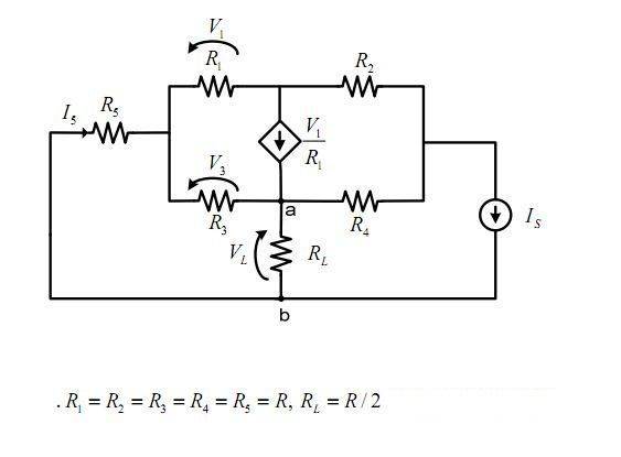

I need to find the thevinin equivalent for points AB.
I know the Is current is splitting equally between R1 and R3, but doesn't go to R2 because of the dependent current source.
so i thought that through:
I(R5) = Is
and I(R3)=Is/2
so the Vab=-3/2*IS*R
but this is wrong.
where is my mistake?
thanks!

1. Let Ig = 0, put V1 across RLand compute i. Then thevenin Req = V1/i.
2. Restore Ig, compute V across RL. Thevenin current source then is V/Req.
