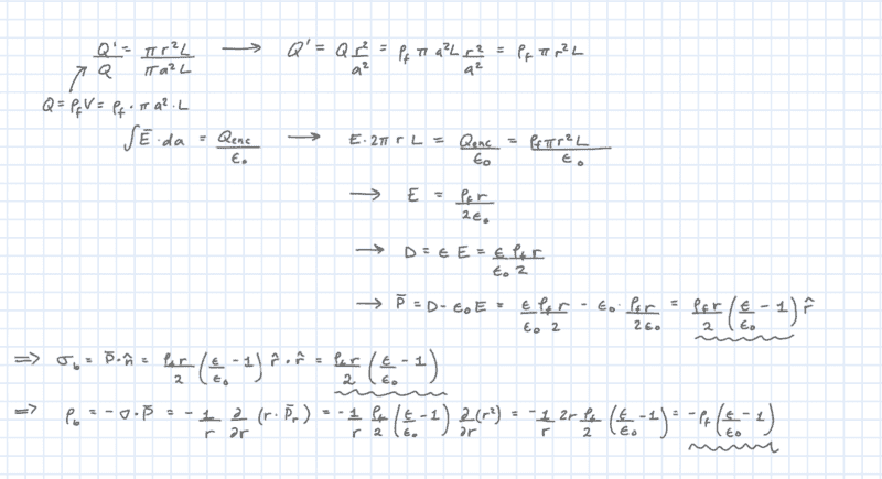

I was trying to solve it using the formula for polaresation P = ε E - ε0 E. Then I tried to solve for E which is D/ε and D= ρf/ε. So at the end, I will have something as P = pf- (ε0ε).
ρb = -∇ * P = 0 so σb = P * n = ...? I am unsure what the direction for the polaresation should be? I need guidance for my solution, I would appreciate any suggestens in changing anything in my solution.

I am trying to solve D but I don't know how to do so, when having the divergence you gave me. I tried to re-write it in integral-form, but at the end I got D = Q_f / A, and I re-wrote Q_f = ρ_f * volume
Is that correct? Which give me that D = ρ_f * a / 2 and the volume is \pi * L * a^2 and the area is 2 * a * \pi * L.

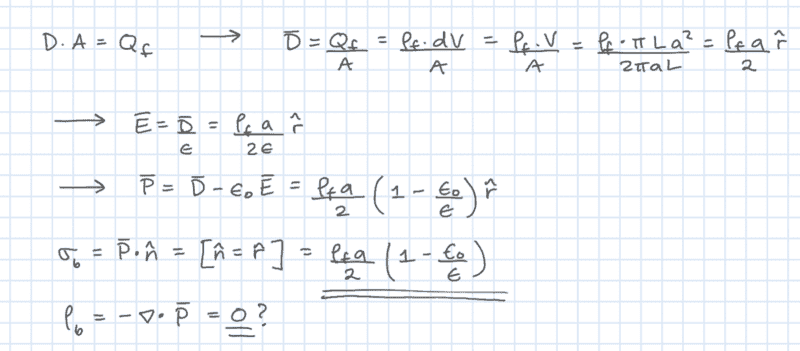

I tried to follow your advice, but I am still unsure of the answer. Is the bound density charge equal to zero? Could be please have a look at my calculations in the attached file?

You need to find D inside the cylinder, that is ##r<a##. You need to redo the calculation with that in mind. What is the enclosed free charge if that is case?

shouldn't it be the same? I don't know, if possible could you please show me how?
the charge will be ρ_f, valume=$$-2L/\pi a^2$$ is it possible that the charge will be negative
Consider a cylinder of radius ##r<a## and length ##L## inside the other one. What is the flux through the surface of this cylinder? That's the left side of the equation. How much free charge is enclosed by this smaller cylinder? Also, look here for how to do the integral to find the E-field. Scroll down to the very bottom for the section "Inside a Cylinder of Charge."

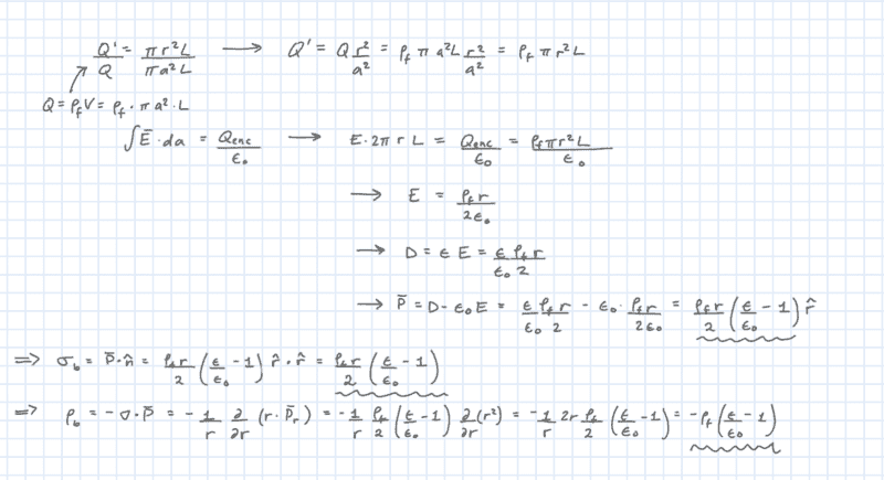

So you mean like this? is this right?
Likes vanhees71
It is right so far. You have correctly found the bound charge densities. Part II of the question asks you to "verify from these that the total bound charge per unit length of the rod is zero." Do that and you will be finished.

As for the calculations of the D-field, I re-did my calculations according to you advice, please have a look and see if this is what you mean?
Yes. Now you can finish the problem as I indicated in post #14.

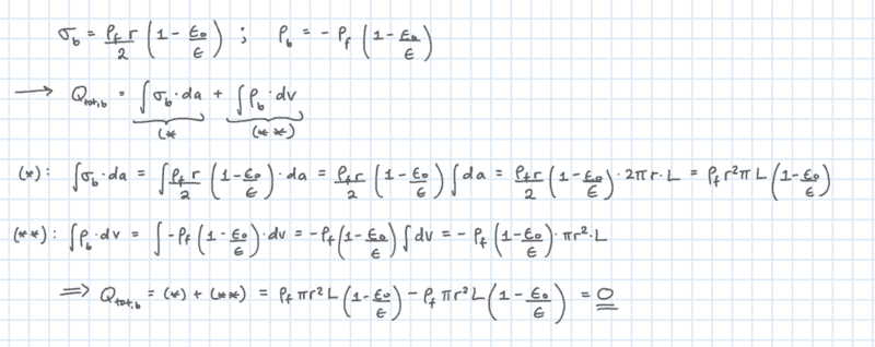

Yes, I already tried to do it while waiting for your answer. Please have a look at the attached file below.
Likes kuruman
Well done!

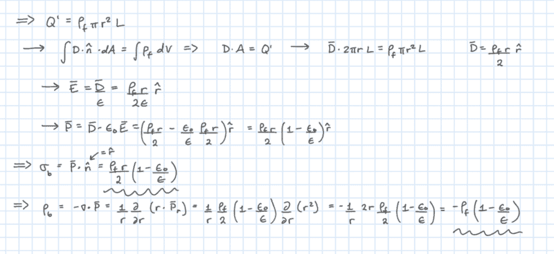

Now that I calculated the polarisation
$$ \mathbf{P} = \frac{\rho_f r}{2}\left( 1- \frac{\epsilon_0}{\epsilon} \right) \hat{r} $$
I was able to calculate the bound charges
$$ \sigma_b = \mathbf{P} \cdot \hat{n} = \frac{\rho_f r}{2} \left( 1 - \frac{\epsilon_0}{\epsilon} \right) $$
$$ \rho_b = - \nabla \cdot \mathbf{P} = - \frac{1}{r} \frac{\partial}{\partial r}(r \mathbf{P}) = - \rho_f \left( 1 - \frac{\epsilon_0}{\epsilon} \right) .$$
And the total bound charge will be
$$ Q_b = \int \sigma_b da + \int \rho_b dV = \rho_f \left( 1 - \frac{\epsilon_0}{\epsilon} \right) \pi r^2 L - \rho_f \left( 1- \frac{\epsilon_0}{\epsilon} \right) \pi r^2 L = 0. $$
(The full solution is published in the previous replies)
But somehow this is incorrect and I don't seem to find the problem in this solution. The polarisation is correct but the bound charges ## \sigma_b## and ## \rho_b ## are incorrect or there is some explanation missing there. I would assume for example that ##\sigma_b ## has a dependence of ## r ## and that somehow should have an explanation to it related to the question. I need some guidence to understand the problem, so that I can re-do the calculation or maybe understand better with an explanation.
The surface bound-charge density is not a function of ##r##. Let's say that the radius of the cylinder is ##R##. Then ##\sigma_b=\frac{1}{2}\rho_f R(1-\frac{\epsilon_0}{\epsilon})##. That's constant and does not depend on ##r##. The volume bound-charge density is also constant. Why does that bother you?
Likes Gustav
But why did we change the ## \sigma_b ## from ## r ## to ##R##?
Because the surface charge density (by its very name) refers to charges on the surface of the cylinder which is located at ##r=R##. Any charge, bound or free, that is not on the surface is part of the volume charge density and that is anywhere in the range ##0<r<R##. You are confusing ##r##, which normally stands for "position at any distance from the axis within the cylinder excepting the surface", with ##R## which stands for "position on the surface of the cylinder excepting the inside."
Likes Gustav
Okay, now I understand. As for the calculation of the volume density charge, is it correct?
Yes, it is. You could check that because you are supposed to show that the total surface charge plus the total bound charge must be zero. I thought you did that in post #21 but you didn't really do it now that I look at it. You sort of finessed the surface charge density part. Since both densities are constant there is no reason to integrate. Just do separately
Total surface charge : ##q_s=\sigma_b\times (\text{surface of cylinder})##
Total volume charge : ##q_v=\rho_b\times (\text{volume of cylinder})##
then see if the two add to give zero.
