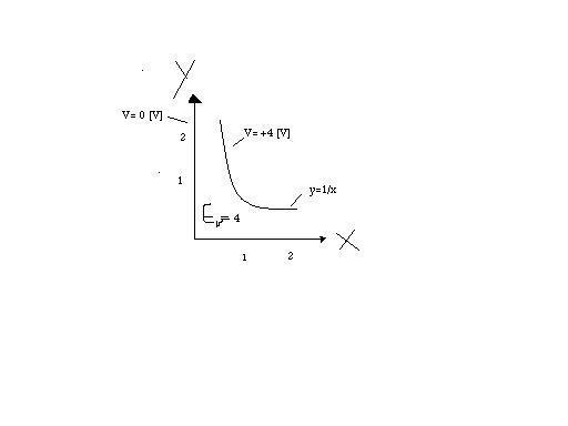

would you show me how to find the capacitance per meter for this following geometry. My prof mentioned it but didnt talk much about it, he insisted that we do some reading on our own
In the figure,. The corner surface along the x and y-axis is held at potential of 0 Volts, and the hyperbolic surface y=1/x is held at potential of +4 Volts. The surfaces extend from –infinity < z < +infinity (out the paper) and extend towards infinity in the x and y directions, but the positive and negative surfaces never meet. The dielectric between the plates has a relative permittivity of €r= 4
a- Prove that the potential function between the conducting surfaces is V(r)= 4xy Volts where x and y in meters
b- Find the Voltage Vab between the points Pa(0.2,1,1) and Pb(1,0.5,2)
c- Find the surface charge density at the point (0,1,0)
You are looking for a function V(x,y,z).
Now, this function is independent of z, by symmetry, so you really need a function V(x,y). In addition, from the graph, when y =1/x, V must be a constant equal to 4.
So V(x,y=1/x) =4.
Clearly, the function must be a function of the *product* xy, so you actually have V(x,y) = V(xy).
However, for infinite plates, the E fields are constant, so if we calculate [itex] E_x = - {\partial V \over \partial x} [/itex] let's say, we better get a constant. So the function must be linear in x. For the same reason it must be linear in y.
So that leaves us with V(x,y,z) = C_1 xy + C_2.
Imposing that V =0 at x=0 or y=0 gives C_2 =0. Imposing that V =4 at y=1/x gives C_1 = 4.
Just plug in the coordinates in V(x,y,z) and subtract.
The x and y components of the E fields are given by the partial derivatives I gave above. Also, you must have seen the equation relating the E field near the surface of an infinite plane to the surface charge density [itex] \sigma[/itex], right? You set the two equations for E_x equal and it will give you sigma of the vertical plate (which will be a function of y). Same for the horizontal plate.
Patrick
Thanks for the help. But I always been thinking we assumed its C1.XY We know there has to be multiplication but why in this form, it can be X/Y , Y^-1 . X ,...

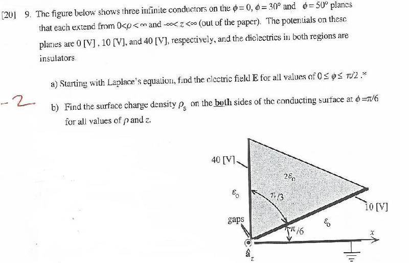

I was lookin at this problem and had some problem, would you guys please help ?
I Just worked it tru. Never mind :)
