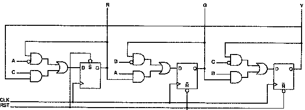

You must sketch a ( synchronous ) logic state machine like this:
http://ece224web.groups.et.byu.net/labs/08_4x7_Segment_Display/4x7_h3.gif [Broken]
and then you can design a logic circuit like this:
. . . or you can implement it by relays or a μ-controller.
The important thing is, that when you sketch the logic diagram, you will have to consider what is going to happen if you press both buttons at the same time: Will the door be disintegrated ?

Trying to implement a discrete state machine in digital logic is not a flexible approach, and the design is very difficult for a beginner (both to design, and to implement)
(Nearly all digital designers implement state machines in an HDL and compile to a hardware solution in an FPGA or cell library)
Buy an arduino and a shield (IO board) to drive the motors. Choose the shield based on what kind of motors (servo, stepper, etc). You can easily implement what you are doing, and then adapt it to many other functions and projects. The challenge will be a steep learning curve in the beginning as you learn the hardware, the development environment, and the programming languages. There are MANY tutorials on line, and you will probably find example designs that are very close to what you want to do.
