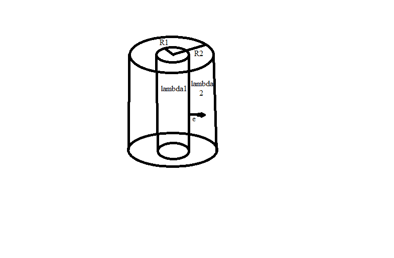

Two thin cylindrical shells, respectively with radius ##R_1 = 12 cm## and ##R_2 = 20 cm## and height ##D = 100 m##, are concentric and characterized by a charge density ##\lambda_1 = -0.38 \frac{\mu C}{m}##, for the internal cylinder, and ##\lambda_2 = 0.32 \frac{\mu C}{m}##, for the external one. An electron (##m_e = 9.1 \cdot 10^{-31} kg## and a charge ##e = 1.6 \cdot 10^{-19} C##) is released stationary from the internal cylinder's surface; what is the velocity when it reaches the other cylinder?

I did a drawing of the exercise, just to be sure I'm getting this right.

So going back to the cylinders: does the charge from the outer cylinder matter for the field inside?
No, it doesn't matter. Only the charge inside matter. This means I only have to calculate the field inside the outer cylinder(which it is the field outside the internal cylinder) ##E_1##, but I have the linear charge density ##\lambda_1## and ##\lambda_2##, not the surface charge, right?
You have the surface charge of the inner cylinder, but a single charged line along its symmetry axis would produce the same field.
So it's okay to write this:
##Q_1 = \lambda_1 D##
##E_1 2 \pi r D = \frac{\lambda_1 D}{\epsilon_0}##
##E_1 = \frac{\lambda_1}{2 \pi r \epsilon_0}##
And I don't have to calculate ##E_2##, right?
Well, you know ##E_2=0##.
Good, now you have everything in place to calculate the velocity.
