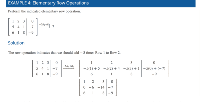

To my understanding, a matrix is just a way of representing a system of equations in an organized format.
So for example, if we have some system of equations, we can get them into standard form, and translate them into what's known as an augmented matrix. This is similar to using synthetic division for dividing polynomials.
Now one rule for elementary matrix operations is that:
Some row, ##j##, can be replace with the sum of itself and a constant multiple of row ##i##- denoted as ##(cRi+Rj)##.
Now my questions is, why doesn't this change the solutions to the system of equations?
Take for example the matrix in my attached picture. We are multiplying ##R_1## by -5, and then adding that result to ##R_2##. Rows 1 and 3 remain the same as when we started, but Row 2 has changed in a way that is not a multiple of itself in the given matrix. I understand that this process is to get the matrix into row echelon form so that we can perform Gaussian Elimination, but I don't understand why our solutions haven't changed now that we have a different multiple of Row 2.
Yes, as it can be seen as such, no, as it is not the only way to view what's going on.
If the ##i-##th row is the equation ##f_i(x_1,\ldots , x_n)=b_i## and likewise ##f_j##, can you show, that a certain set of numbers ##a_k## for the ##x_k## which satisfies ##f_i(a_k)=b_i## and ##f_j(a_k)=b_j## also satisfies ##(\alpha f_i + \beta f_j)(a_k) = \alpha f_i(a_k) + \beta f_j(a_k)= \alpha b_i + \beta b_j\,?##

Mark44 said:
Because you're adding equal quantities to both sides of the equation you modify.
So let me ask this. Is the reason that we multiply by a variation of another row, and add that to the row we want to change because the numbers in the matrices represent variable coefficients? So say I wanted to change ##a_{21}## from 5 to 1. I cannot simply subtract everything in the row by 4 because those numbers are variable coefficients. It would be like saying ##5x-4=1x## which is not true.
To change ##a_{21}## from 5 to 1, I would need to multiply a row by a factor that, when added to row 2, would change the 5 to a 1.
So let me just isolate one equation of the matrix that we'll say is of row 2.
This row consists of numbers, and these numbers correspond to the variable's coefficients of the terms in its respective equation in the system of equations.
In a normal equation, I can add or multiply whatever I want, as long as it's done on both sides.
In the case of the matrix, it is the same except for one aspect. Every number of the LHS of the matrix is being multiplied by some variable. Since this is the case, I can't just add some number to it, even if I do it on both sides of the equation. To add the the LHS, what really needs to be done is to find a multiple of another equation in the matrix and add that to the row we want to change. In doing this, we are adding a multiple of ##x## to ##x##, a multiple of ##y## to ##y##, and a multiple of ##z## to ##z##.
Yes to both of your above posts.
Likes opus
Ok then! Thanks!
Likes Tom.G
