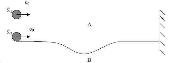

The two bodies shown at the picture are moving along the surfaces marked as A and B with no friction and no rotation and with the same initial velocity. Which one will arrive first at the wall? We may assume that the second body never looses contact with surface B. Note that this question was posed to students with no knowledge of integrals or derivatives. Any well explained solution is most welcome.

Nope they will not reach the far end at same time.
Think Conservation of energy. Think about their Kinetic energy at different points in time.
Think "velocity is a vector quantity". B's horizontal velocity is not changed by going down and then back up the depression. Since the time to reach the wall depends only on horizontal velocity both will reach the wall at the same time.
You are wrong. The vx velocity while the body moves along the curve is larger than v0, (increasing to an amount while going down and decreasing to its original value v0 while going up). So the second body travels the horizontal distance of the gap faster than the first body.

Good question - the answer depends only on conservation of energy, Newtons 2nd law, and the fact the laws of Newtoninan mechanics are symmetrical when time is reversed.
First consider the motion from the start to the bottom of the depression. The horizontal component of force on the body is always >= 0 (measuring positive from left to right). Therefore the horizontal speed is >= the speed on the straight track.
Therefore the particle will reach the bottom of the depression sooner.
You know the particle does not leave the track, therefore there is no energy loss by impact when it "bounced". By conservation of energy, the particle will have the same energy before and after the dip, and therefore the same velocity.
By symmetry, consider the reversed motion of the particle. By the same argument as before, the time from the centre of the dip to the wall is less than for the straight track.
NB this argument uses the symmetry of Newtonian mechanics with time-reversal - it doesn't depend on the shape of the track being symmetrical about the lowest point.

Usually this problem is posed with the depressed path having a long, flat stretch at the bottom of the depression. In that case it's easy to answer, since the particle taking that path has a higher speed for a longer period of time.
But this case requires more thought (unless I'm missing something obvious), since the horizontal portion of the depression is negligible.
But while it is in the depression, the horizontal velocity will obviously be larger than when it is on the flat section. Therefore, the ball going through the depression will reach the end first.
That's not obvious to me. At any point in the depression, the speed of the particle is:
[tex]V = \sqrt{V_0^2 + 2gh}[/tex]
But the horizontal component is only:
[tex]V_h = V \cos\theta[/tex]
Depending upon the angle and depth, V_h may well be < V_0.
The problem is more interesting than it looks. (Of course, I haven't had my coffee yet this morning.)

The body is moving along a surface and does not lose contact with it. That means V_h cannot be less than V_0
If it were sliding along a wire, the situation is different and you are right, the time of travel could be slower for a deep depression. See also my previous post.

Of course your velocity formula is right.
Because the object is sliding on a surface, the contact force must be normal to the surface and can only act outwards from the surface to the object. While the object is travelling down the slope there is no way there can be horizontal component of force that can reduce the horizontal component of velocity. It can only stay the same or increase.
To deal with the motion up again, consider the situation with time reversed.
If the object were sliding along a wire, the situation is different because there can be a horizontal component of force in either direction. For example if the wire went vertically downwards at some point, clearly the horizontal velocity would be zero at that point.
If the shape of the surface falls away faster than a parabola (whose shape depends on the initial speed) then the object will lose contact with it.

Finding the speed by conservation of energy is fine, but it doesn't tell the whole story. Going back to your [itex]v_h \cos \theta[/itex] argument, the condition that the particle stays on the surface will give a constraint on the possible values of theta (it might be an interesting calculus of variations problem to work out the constraint explicitly) and the consequence will be that[itex]v_h \cos \theta > v_0[/itex].
If the horizontal velocity changes, there must be a horizontal force to change it. As the previous post said, if you draw a free body diagram it's clear that on the way down the depression, you can't have a force that reduces the horizontal velocity.

Hopefully, more thought will show the increased distance is irrelevant. The time to get to the other side depends only on the horizontal velocity and the horizontal distance (which does not vary).
HallsofIvy's answer is the correct one. Whatever horizontal acceleration is picked up going down the hill is canceled by the deceleration going back up. The shape of the depression is irrelevant as long as the elevation is the same before and after the depression. There is simply no net horizontal force.

Once consequence of all this which I do find counter-intuitive is: suppose the depression is starts as a parabola, so the particle just skims down it without losing contact. Then there is a small radius curve at the bottom and a parabola going back up.
In that case the time taken would be almost identical, because the only part where the horizontal velocity was faster would be the small curve at the bottom of the depression. But, assuming the diagram in the question means the curve is sufficiently smooth, there must always be a part at the bottom where the horizontal velocity increases, because at the lowest point, the depression IS horizontal, and Doc Al's formula correctly says the horiz. velocity is greater at that point.
