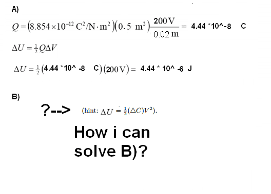

A parallel-plate capacitor with plates of area (0.5m) * (1m) has a distance separation of 2 [cm] and a voltage difference of V = 200 [V], as shown in Fig.
a) Find the energy stored
b) keep d1 = 2 [cm] and the voltage difference V, while increasing d2 = 2.2 [cm]. Find the energy stored (hint hint u=1/2CV^2)
You could try dividing the capacitor into lots of narrow capacitors in parallel.
but how if d1=2 and d2=2.2, can you still use the capacitor formulas even if its a uneven capacitor?
You have to divide it into smaller capacitors than that.
can you give me a little example please, i just cannot imagine since one side is uneven :(
Have you not done any calculus?
so for example i will use this formula E = Δ V / Δ d, and by dividing the plates in very tiny plates
i can now write E as E = ∑ (Δ V / Δd), but since we V is constant E= V (∑ (1/Δd)) so this will be the same as E=V∫((1/dx)) from d1 to d2 where d=x?
is this approach correct? and then calculate the charge and then the energy?
ok so i was wondering if so for example i will use this formula E = Δ V / Δ d, and by dividing the plates in very tiny plates i can now write E as E = ∑ (Δ V / Δd), but since we V is constant E= V (∑ (1/Δd)) so this will be the same as E=V∫((1/dx)) from d1 to d2 where d=x?

You want to use ##U=\frac{1}{2}CV^2\implies dU = \frac{1}{2}V^2\;dC##
Put the x-axis in the direction the separation of the plates varies.
Divide the width into strips L=1m long, and dx wide... this is a row of parallel plate capacitors in parallel... you know how to find the capacitance of a parallel plate capacitor.
If we put the x-axis so the separation goes like: d(x=0)=2m and d(x=0.5)=2.2m, you can find an expression for d(x)
From that, and knowing that V is the same for all the capacitor elements, you can find:
dC= (the capacitance of the element at position x)
... get this from the expression for the capacitance of a parallel plate capacitor.
Use that to get an expression of form: ##dU = f(x)\;dx##, and integrate both sides.

using [tex] C\equiv \frac{εA}{d} [/tex] where A= area of plates and the distance is a function of x [tex] d(x) \equiv 2 + 0.4x[/tex]
we get
[tex] C\equiv ε \frac{\int_{0}^{1}dy \int_{0}^{.5}dx}{\int_{0}^{.5}(2+.4x)dx} [/tex]then substituting in [tex] U \equiv \frac{1}{2} ε V^2 C [/tex]
we can get
[tex] U \equiv \frac{1}{2} ε V^2 \frac{\int_{0}^{1}dy \int_{0}^{.5}dx}{\int_{0}^{.5}(2+.4x)dx} [/tex]
is this correct?

I don't think so - you have too many integrals.
where am i wrong?
Why not go step-by-step through the suggestion in post #11?
you have:
1. expression for d(x): ##d=2+2x/5## (better to avoid decimals in equations - if you can)
You still need the others:
If the plates are 1m long and dx wide - what is their area?

OP - is your answer 4.22 μJ? Your work is very hard to read.
