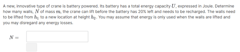

Please help, I'm really struggling to understand how to work this...
work = mass * gravity * change in height
w = m*g*(h2 - h1)
Total energy = Sum of potential energy + Kinetic Energy
work = 1/2Kinetic Energy * Potential energy ^2
w = (1/2 * K) * U^2
m*g*(h2-h1)=(1/2*k)*U^2
rearanged = (2(m*g*(h2-h1))/U^2)=K
We are given
U, m, g, h2 and h1Firstly, is my above working along the right line.
Secondly, how to I show this as 80%?
Please help
w = m*g*(h2 - h1)
Keep it simple. That's the work done -- and thus the energy expended -- to lift one wall. So, how much energy is needed to lift N walls? Set that equal to 80% of the battery's energy to see how many can be lifted.
Don't worry about KE. Just assume the walls are lifted without any appreciable increase in KE.

Imagine that you lift each wall so slowly that it's kinetic energy can always be taken as zero. The work done by the battery to raise a single wall is ##mg(h_2-h_1)##, as you wrote. How much work does the battery then do to raise ##N## walls; and to what fraction of the number ##U## does this correspond?
ok, so N(m*g*(h2 - h1))=U?
and I need to rearrange (N(m*g*(h2-h1))=U
N=U/(m*g*(h2-h1)) right?
Almost. Don't set the energy needed equal to U. U is the total capacity of the battery -- you only want to use a fraction of that total.
Ok, so...
(N(m*g*(h2-h1))=4/5U
N=4/5U/(m*g*(h2-h1))
Now you've got it.
