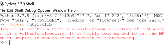

I am trying to figure out the PATH variable because after having downloaded the Python library matplotlib, I get the following error that I don't fully understand:
matplotlib created a temporary config/cache directory at C:\Users\FOG37\AppData\Local\Temp\matplotlib-qqx1v1f5 because the default path (H:\.matplotlib) is not a writable directory; it is highly recommended to set the MPLCONFIGDIR environment variable to a writable directory, in particular to speed up the import of Matplotlib and to better support multiprocessing.
Why was a temporary directory created?

Because the program was told by the environment variable MPLCINFIGDIR to write to the H:/.matplotlib directory.
However H:/.matplotlib is Write Protected. Since it could not write the results there, it created a new directory to save the results.

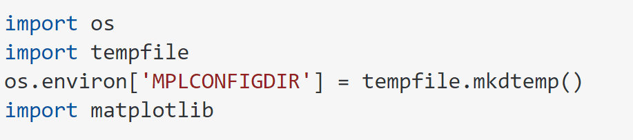

On a different forum, I read that some Python code should be added to my Python programs when using the visualization library matplotlib. I am still trying to make sense out of it and why this code is needed.
Is a temporary directory being created to store the graphs? why? Is the temp directory deleted later unless I save the graphs?
See below:
or
Thanks!
If you want to know some background, the relevant part of the matplotlib documentation is here: https://matplotlib.org/faq/environment_variables_faq.html?highlight=tempdir
If you just want to get it to work, the code in the second image* will work better than the first (because it deletes the temporary directory on exit).
* Rather than post images of code, it is better to post code between [code=Python]...[/code] tags, or use the </> icon in the text editor.
