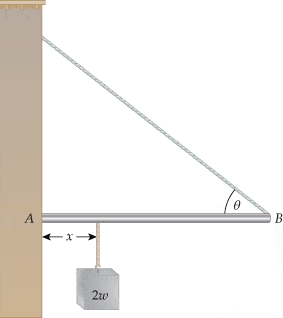

Problem Statement: As shown in the figure below, a uniform beam is supported by a cable at one end and the force of friction at the other end. The cable makes an angle of θ = 30°, the length of the beam is L = 1.50 m, the coefficient of static friction between the wall and the beam is μs = 0.420, and the weight of the beam is represented by w. Determine the minimum distance x from point A at which an additional weight 2w (twice the weight of the rod) can be hung without causing the rod to slip at point A.
Relevant Equations:
Ff = μN
Ʃτ = 0
ƩF = 0
Solution Attempt:
I'm not really sure where to start. Does Fn (normal force) come from the weight of the rod multiplied by cos(30) due to the angle of the cable holding it against the wall? And once I find Fn, I multiply that by μ, giving the upward force of friction. Then, placing the rotational axis at the end of the rod that the cable is attached to (because it's not moving, I can place the axis anywehere) and set Fn equal to the weight of the object being attached multiplied by the distance from the wall. Would that work?
You just need to go about the problem systematically.
Write down the equation for x-components of the forces.
Write down the one for y-components.
Then for moments/torques.
You are going to have a bunch of known and unknown forces in those equations. Of those, the normal force at A and friction at A will be related with the coefficient of friction.

Okay so:
ƩFy: Ff + FBsin30-2w-w = 0
ƩFx: FN - FBcos30 = 0
Ʃτ: -w(0.75) - 2wxm + FBsin30(1.5)
Is that correct?
Assuming the third formula ends with " = 0 ", that looks good.

Alright so all of that is correct, but now what? We don't have most of those variables and the only ones we can solve for are FF/FN. How do we relate w to FN? Everything has to be in terms of "w" as it stands.
What am I missing?
Observer that once you relate friction and the normal force, the first to equations can be solved, giving you all the forces in the system. But you still have the third one to satisfy.
So rewriting ƩFy we get:
μFN - 2w - w = -FBsin30 → -(μFN - 2w - w) = FBsin30
And rewriting ƩFx we get:
FN = FBsin30
We set these equal which gives:
-(μFN - 2w - w) = FN
then
-μFN + 2w + w = FN
then
(-0.420)FN + 2w + w = FN

The way I did mine was:
We need to find the Fb in terms of w then we can eliminate it from the final answer as all the terms in the torques will have w. So I found 0.42Fn=Ff and that Fn=Fbcos30. From there i found Ff in terms of Fb and then put this into Fy to find Fb in terms of w. From here i substituted this into the torque equation and simplified

There is also another approach, somewhat more complex but "more correct". Note that by letting ## F_f = \mu F_n ## we assume that the friction is maxed out. But we do not really know if it is going to be maxed out at a minimum or at a maximum of ##x##.
So the more correct approach would involve not letting ## F_f = \mu F_n ## just yet, and instead solve the system of three equations in three variables ##F_B, \ F_f, \ F_n ## and one parameter ##x##. Then find the range of ##x## where ## F_f \le \mu F_n ##. You could try that.

Alright I got it wrong. Here's what I did:
Using that algebra step, I got:
FB = 1.171w
Then I substituted that in for FB in:
Giving:
-w(0.75) - 2wxm + (1.171w)sin30(1.5) = 0
Combine like terms and multiply out:
0.13w = 2wx
Divide over:
x = 0.065m
This is wrong according to Web Assign. It seems too small, but who am I to say so. So where did I stray?
I obtain ## F_B = \frac {3w} {\mu \cos \theta + \sin \theta} \approx 3.473 w ##.

This is almost exactly the equation I got. Just multiply the numerator and denominator by ##\mu##.
FB = (-3w/-μ)[(1/cos30)-(-μ/sin30)
This is wrong. You cannot go from ## \frac {a} {b + c} ## to ## a(\frac 1 b + \frac 1 c)##, these are not equal.
As for the tool, click the Quote button on my message, you will see some code there. That code is LaTeX. When you are in (advanced) reply screen, there is a ##\sum## button, which you can use to find codes for whatever math symbol you need. Or you can just search for a LaTex reference online.
