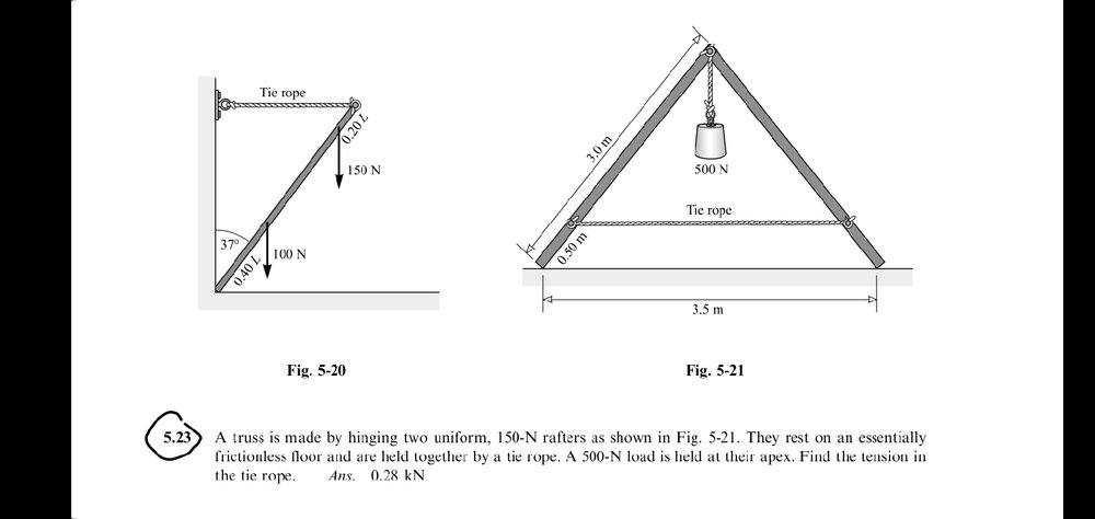

Standard methods: pick a component of the system, draw a free body diagram for it showing all the forces, then write equations representing some of the balances that exist, such as horizontal forces, vertical forces and torques about some chosen axis.Butterfly41398 said:Homework Statement:: Find the tension in the rope
Relevant Equations:: F=ma
The answer is 280N but I don't have any idea hoe to get to the anseer. Atleast a hint would help.
Coplanar forces are forces that act on an object in the same plane or on the same surface. This means that all of the forces have the same direction and lie on the same flat surface.
To determine the equilibrium of coplanar forces, you must first draw a free body diagram of the object and label all the forces acting on it. Then, use the equations of equilibrium (sum of forces in the x-direction and sum of forces in the y-direction) to solve for any unknown forces or angles.
