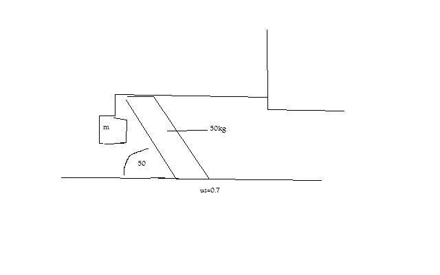

Basically, the string is attached a to a wall at the top right, with a mass m hanging on the other end. It asks to find the max mass m that can hang before bottom of the rod slips.
Fnetx=0
Fnety=0
I know that Ft=mg for the hanging mass m.
Then for the x forces on the rod: Ft=Ffs
so usFn=mg
But I don't know what to do with the angle 50 degrees. You have to include it somewhere right?
I was thinking us(50)(9.8)(sin50)=m(9.8) but I don't know if that's right.
Thanks
Adam
Welcome to PF.
There are also torques to consider, which must sum to zero. (The angle will play a role here.)
Also, while the tension in the vertical section of string is mg, in the horizontal section it can be something different.
I was thinking about the torque, but don't you need to know the length of the rod to find them?
Let the rod length be L, and see how the torque equation works out.
