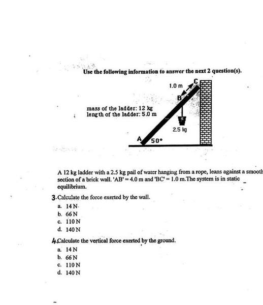

I tried to find the force of gravity on both the ladder and pale. The I thought that the wall would have to excrete that exact same force to hold it up, but that wasn't the answer.

How would we go about solving this one? I guess we would first establish the foot of the ladder as the pivot point, then calculate the torques? Where I get screwed up is calculating the torques.

This time you have got the correct path. Carefully calculate the torques ( be careful about the signs) due to all forces taking the foot of the ladder as the pivot point, then and equate it to zero (which is the necessary condition for rotational equilibrium)!
How does this sound?
Torque of Ladder: (12kg)(9.80)(2.5m)(sin50)=-225.2(negative because clockwise)
Torque of pale: (2.5kg)(9.80)(4.0m)(sin50)=-75.1(negative because clockwise)
-225.2+-75.1=(F)(5.0)(sin50)
I have made a mistake somewhere but can't tell where. Can you please tell me where I have made a mistake? Thanks.
Look once again at the equations you have written.
For the expressions of the torque due to the ladder's and bucket's weight, which component of their weights are you taking? Should they be the sin or the cos component?? (Use a little geometry and that shall help you figure out your mistake)

(12)(9.80)(2.5)(3.21)/5+(2.5)(9.80)(4.0)(3.21)/5-F(5)(sin50)=0
I don't understand how this works. It gets the right answer-66N, but for example why divide by 5?

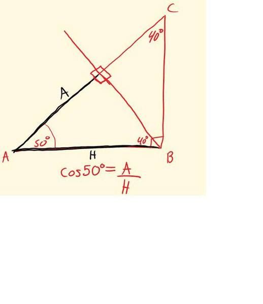

To get the correct angle do the following:
Draw a right triangle ABC (rt angled at B, base AB)with angle CAB=50. Now if you draw a line perpendicular to AC and passing through C, then what angle does the line make with BC?? (You know that angle ABC is 40)
In this problem, the line AC is somewhat like the rod and the vector along BC is the line of action of gravity, so the torque you must take its component that is perpendicular to AC, which is the cos component!
Hope you got it now!
So far as the solution you have put up is concerned, look at it a bit more carefully, the term (3.21/5) is indeed the value of cos 50! That's why its correct and you get the correct answer!
like this?
so the component for the wall would be sine? How would you know that?
I know for the bucket and ladder it's cose. but what about the wall.
