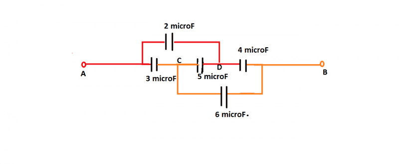

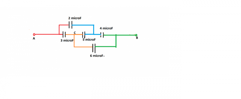

Find the equivalent capacitance of the combination between A and B in the figure.
For Equivalent Capacitance in series
##\frac{1}{C}##=##\frac{1}{C_1}##+##\frac{1}{C_2}##For Equivalent Capacitance in parallel
##C##=##C_1##+##C_2##...

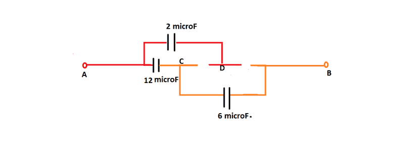

Three capacitors of capacitance 3μF ,5μF and 4μF are in parallel.Hence their equivalent capacitance is 12μF.
We can see the capacitor of capacitance 2 μF became isolated.The reduction process left it with only one lead connected to the circuit.Without both leads connected a component cannot carry current. Charge cannot move onto or off of a capacitor through one wire alone. The capacitor thus has no influence, no utility, as far as the circuit is concerned.

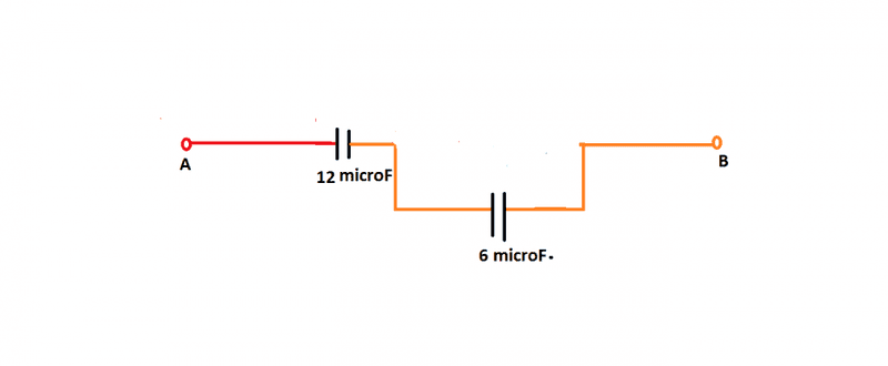

Here capacitors of capacitance 12μF and 6micro F are in series.Using the formula ofequivalent capacitance of capacitor in series I got the answer for equivalent capacitance between A and B as 4μF but the answer given in textbook is ##\frac{10}{3}##μF.I want to know what went wrong.
Thanks.
It is a bridge circuit with 5 microF as the bridge.
In this circuit, there are no capacitors in parallel.
But these three capacitors share two nodes (red and orrange)so they must be in parallel.
No, C and B do not belong to the same node. Use a different color for the lines connected to B.
There are neither parallel, nor series capacitors in this circuit. It is a bridge.

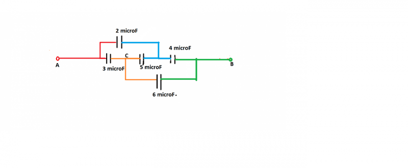

Then orange color wire would be touching whatever colored wire I 'll use for line connected to B.It is wrong because any wire segments that touch must be the same node (color).
The orange wire does not go though the 6 uF capacitor., and is not connected to B.
Likes gracy
A node is made up of wire, only wire, nothing but wire, highly conductive copper or silver wire. These wires can together make a join that has any shape, but the node is still made of nothing but wires connected together.
Gracy, You have to sort out the identification of the nodes first, as pointed out by others. Then you will reach the conclusion as voiced by @NascentOxygen, that there are no opportunities for combining parallel capacitors. This is based on the topology of the circuit.
A slight re-arrangement of the diagram on the page will make this more obvious, but you'll need to make a try at it. Another person (@azizlwl) mentioned that the circuit is a "bridge". This is a well-known circuit configuration. Look up images of "bridge circuit" so you can get an idea of how such a circuit looks when the author isn't trying to confuse you for the sake of making an interesting puzzle.
As is often the case with these sorts of problems the author as tried to confuse you by drawing the circuit in an "inconvenient" way for recognition of helpful symmetries, but I'll let you know in advance that the author has also included a trick via the component values that will eventually make things simpler. But before we get there you need be clear about the nodes and the lack of parallel and serial simplification opportunities for this topology.
So see if you can re-draw the circuit in a way that shows the symmetry of a bridge circuit.
Likes gracy

But where I did this mistake?
Oh,yes I got it.Thanks.
gneill said:
You can if you do it properly
If there is no parallel or series capacitor how can I solve it with the previous method?
Is it correct now?
You cannot. That's the point of this particular problem. There are circuit configurations that cannot be reduced by the basic series and parallel reduction methods because there are no series or parallel opportunities to exploit.
When you run into such a situation you must resort to more powerful methods of circuit analysis, or, as is the case with this problem, look for the trick that the author incorporated by a clever choice of component values. Hint: it relies on symmetry, which is why the author disguised the circuit layout as he did so the symmetry would not be obvious. You should be able to re-draw the circuit to uncover the symmetry.
Bridge circuit is it the powerful method you are referring to?
A bridge circuit is a particular circuit layout. The methods I refer to include Y-Delta and Delta-Y transformations, Kirchhoff's voltage and current laws (KVL and KCL), mesh analysis, and so on. I don't believe that you've covered any of these yet, and they are not strictly required for this particular problem thanks to the choice of component values.

In this particular problem which method shall I go for?Bridge circuit method?
"Bridge circuit" is not a method; It's a particular arrangement of components.
However, there are certain symmetries associated with that layout that you can take advantage of if the component values are conveniently chosen. Did you find out how a nicely drawn bridge circuit appears? Can you re-draw your circuit in that style?
Likes gracy

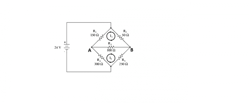

Find an post a picture of a typical bridge circuit. It doesn't matter if its components are capacitors or resistors, it's the layout of components that is of interest.
Good. Now, can you see that the circuit layout in this problem matches the drawing above (except for the component values)?
If so, substitute in the component values from the problem at hand into the above drawing. Then we can work on seeing the symmetry.
  • #31

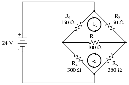

A fine choice for an image. Now, note the layout. Imagine that the middle resistor R3 is removed for now (This resistor is called the "bridge" component, since it forms a bridge between the middles of the two parallel branches). On the left there are two resistors R1 and R4 that form a potential divider across the 24 V supply. On the right side is a similar pair, R2 and R5, which form another potential divider for the 24 V. So without R3 there you could easily determine the potentials at those two middle nodes with a voltage divider formula used on each pair.
Now, the potential that a potential divider produces at its center node depends upon ratios. If the components of two different potential dividers have the same ratio, both potential dividers will produce the same voltage division. In the above circuit, if R1/R4 = R2/R5 then the middle nodes of the bridge would be balanced (Ignore the actual values that were included on the picture, we're just looking at theory right now). This is the sort of symmetry that you look for in bridge circuits that can be helpful: Equal component ratios on either side of the bridge let you know that the unloaded (no R3) potential dividers would produce the same potential.
Now, if that were the case (equal potentials) then laying R3 back into the circuit would do nothing! It would have the same potential at both of its connections, so no current could flow through it. The circuit would be undisturbed in any way by reconnecting R3. So R3 might as well not be in the circuit (when the bridge is balanced).
Once you have digested that, see if you can follow jbriggs444's advice and match the components from your circuit to their equivalent locations on this new bridge diagram. For bonus points, determine if your bridge is balanced!
