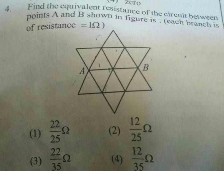

@TSny ,
I came across a similar problem (hope I am not wrong :smile: ). Please see the attached picture . I do not have the answer key . Could you please confirm whether you get 22/35 Ω as the answer .
Thank you

Jahnavi said:
@TSny ,
Thank you
Yes, I also get 22/35 Ω.
