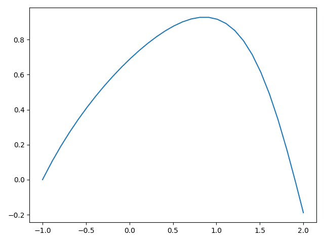

For the DE ##\frac{dy}{dx} = y^2-x,## the long term behaviour of the Euler approximations with step sizes ##h = 0.5, 0.25, 0.125## with initial condition ##(-1,0)## all tend to ##\infty##. However, the long term behaviour of the actual solution with the same initial condition actually tends to ##-\infty##.
What would I call this failure——failure of self-consistency, failure of convergence, failure of structural stability, or failure of stability?
N/A
I had thought it would be failure of structural stability since in structural stability qualitative behavior of the trajectories is unaffected by small perturbations, and here, even tiny deviations using ##h## values resulted in huge effects. However, apparently that's not the case, and I'm not sure which failure this falls under...

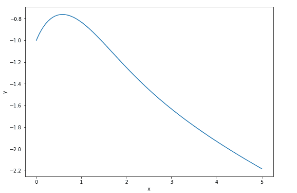

fresh_42 said:
I cannot see a solution which tends to ##-\infty ##
https://www.wolframalpha.com/input/?i=y'=y^2-x+
Not with ## y(0) = 1 ##, but with ## y(0) = -1 ## it does...
Python:
import numpy as np
import matplotlib.pyplot as plt
from scipy.integrate import odeint
# ODE
def odeFunc(y, x):
  return y * y - x
# Initial conditions
y_0 = -1.0
start = 0.0
stop = 5.0
step = 0.001
listOfXValues = np.arange(start, stop, step)
arrayOfYValues = odeint(odeFunc, y_0, listOfXValues)
# Plot results
fig = plt.figure(1, figsize=(8, 16))
ax1 = fig.add_subplot(311)
ax1.plot(listOfXValues, arrayOfYValues[:,0])
ax1.set_xlabel('x')
ax1.set_ylabel('y')
plt.tight_layout()
plt.show()
