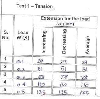

evaluate the value of extension ( x) which elongate under the action of load (w) of 6 N ? [Use your results obtained from rest 1 ]
please help me How i can solve this question because I don't understand it clearly
plese I want your help
any one here ??
What is the question? What do the three columns on the right mean? Why do you have the same values for Increasing and Decreasing?
beacuse when we mesure we got same value to Increasing and Decreasing
I can see that, but I have no idea what you're trying to do here. What do Increasing and Decreasing mean in your table?
this experiment of Speing balance
when we increasind ( Load ) the space we are got in decreasing is same .
we start by 0.1 N then 0.2 then >>>> to 0.5

OK, for the first row in your table, you have Load = .1 N. Did the spring length change (increase) by 29 mm? If the spring got longer, it can't have also gotten shorter, so I don't understand the purpose of the Decreasing column or the Average column.
Look Dear
Experience as follows :
First, we put Spring on the board and a paper under spring to measure the distances between each point from the beginning to the end point of extension for each weight
Then we increased laod to ( 0.2 n ) the measurement was between the starting point until end point of extension is 51 mm (( same steps for all load ))
Then we've decrease the weights ( Every time one ) from end ( 0.5 ) to (0,1 ) we got same measurements
then We calculated the average by calculat increases and decreases and divide by 2
For information, there is a Positive relationship between weight and extension
plese help me
Dr. Mark44 where are you ?
It looks to me like the spring will extend about 27 mm per .1 N, or about 2.7 cm per N. How much will the spring extend with a weight of 6.0 N?

x = w/k
but from where we got the value of k ?
You have the force (mg - Newtons), and you have the displacement ([itex]\Delta x[/itex]).
x = w/k =
6/k from where we got the value of k ? here we try to find x
The purpose of your experiment was to measure values of F (the weight) and x.
plese i can't understand help me
plese help me
The formula is F = kx.
The table you made has measured values of F and x, so solve for k in the equation F = kx.
