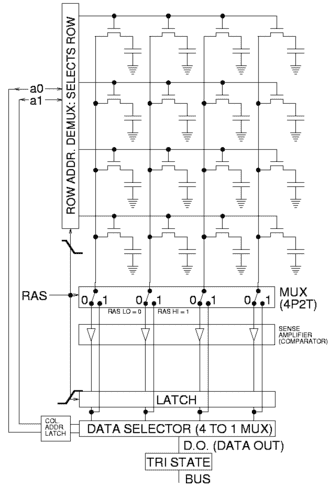

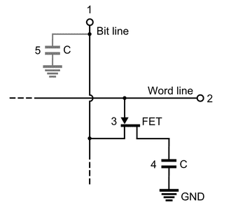

  1. How does the sense amplifier when reading a bit work in a DRAM?
  2. How does the RAM refresh the capacitor in a DRAM?

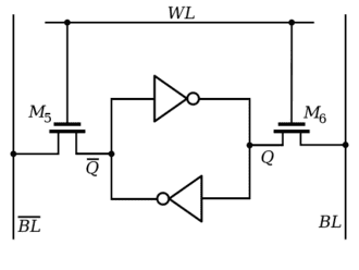

  3. What is the configuration of a chain of SRAM cells?
  4. How does the controller address cells?

1. The sense amp is a mosfet gate that senses the voltage on the capacitor.
2. It reads and then re-writes the capacitor often enough to prevent loss of information.

What type is used more commonly? I have heard that SRAM is used more for CPUs caches, ( which I know what they are), and DRAM is used for RAM, is this true
SRAM is faster to access since for one reason it doesn't need a refresh cycle, but consumes a bit more power to operate. ( ie accessing the memory )
Can perhaps give a diagram of the sense amp MOSFET in raltion to the memory cell grid?
Is the refreshing cycle pulsing?
There are many answers to such a general question. At the risk of giving you information you already know, I will refer you to a search engine called google that may be of some help.
While what you say is true, the main reason SRAM is faster (and uses more power and takes up more area) than DRAM is each SRAM cell contains small amplifiers in it to buffer the logic value from the column capacitance. The DRAM is a passive device and depends on amplifiers at the bottom of the columns (sense amps).
