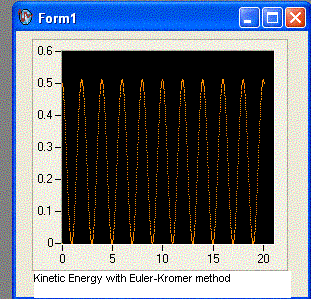

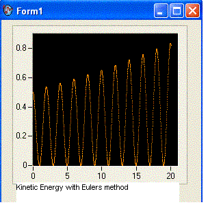

Both Eulers and Runga Cutta are FIRST order methods. You cannot directly solve a 2nd order equation using them. The first step is to reduce your 2nd order equation to a system of First order equations. In this case if you let:
[tex] U(t)= \frac {d \theta} {dt} [/tex]
You can express the original DQ as
[tex] \frac {d U(t)} {dt} = - \frac g l sin(\theta) [/tex]
Now using a simple Eulers method you arrive at the following eqations to be computed
[tex] \theta_{n+1} = \theta_n + h U_n [/tex]
[tex] U_{n+1}= U_n - \frac {hg} {l} sin(\theta_n)[/tex]
here is a table of values I computed for h= .1 l=1f, with intial conditions Theata(0)=.1 U(0)=0
