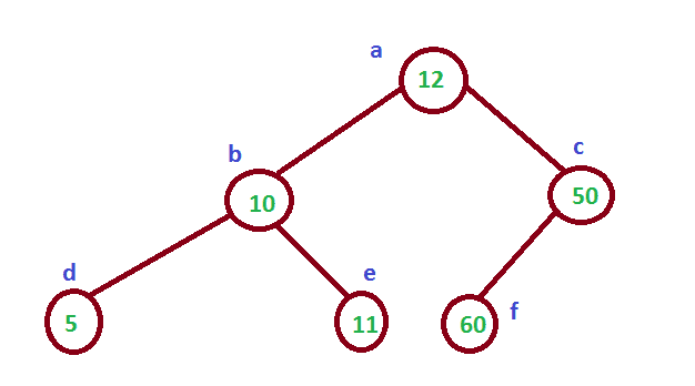

If we have, for example, this tree $B$:
and we want to divide it into two new trees $B1,B2$, so that the first one contains all the keys of $B$ that are smaller than $5$ and the second one contains all the keys of $B$ that are greater than $5$, won't we compare all the values of the nodes with $12$, instead of $5$? (Worried)
Or have I understood it wrong? (Thinking)
I misread the problem statement, treating $k$ as the value of the root node, which it doesn't have to be. (Blush)
I found this to be an interesting exercise. The following somewhat lengthy C program solves the problem. I recommend that you read this, even if you're not familiar with C. There are several binary search tree functions that are applicable in a lot of places.

I want the algorithm to be of order the height of the original tree.. (Nod)
So, in pseudocode should it be like that?
Code:
pointer appendToTree(pointer root,poiter p) {
    int x;
    pointer q,parent;
    if (root==NULL) {
        return(p);
    if (p==NULL) {
        return(root);
    x=p->key;
    parent=NULL;
    q=root;
    while (q!=NULL) {
        parent=q;
        if (x<q->key) {
            q=q->left_child;
        else {
            q=q->right_child;
    if (x<parent->key) {
        parent->left_child=p;
    else {
        parent->right_child=p;
    return(root);
void splitTree(pointer root,int x,pointer lessRoot,pointer greaterRoot) {
    pointer p,*parent;
    p=root;
    while (p!=NULL && p->key!=x) {
        parent=p;
        if (x<p->key) {
            p=p->left_child;
            parent->left_child=NULL;
            greaterRoot=appendToTree(greaterRoot,parent);
        else {
            p=p->right_child;
            parent->right_child=NULL;
            lessRoot=appendToTree(lessRoot,parent);
    if (p!=NULL) {
        lessRoot=appendToTree(lessRoot,p->left_child);
        p->left_child=NULL;
        greaterRoot=appendToTree(greaterRoot,p);
Or is it wrong? (Thinking)
At the algorithm [m] splitTree [/m], why is [m] p [/m] a pointer, but [m]parent[/m] a pointer to a pointer? (Worried)
Can the type of a function in pseudocode be [m] pointer [/m] ? :confused:
