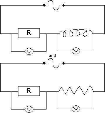

OKay, here's what we did (we've already did the experiments, and now have to write the report about it, which has to be handed in TOMORROW!):
We made 2 electric circuits, one with an capacitor and resistance, the other with a self (i don't know if that's the right name, but it's that thing with self-induction?) and resistance, on AC voltage. We measured the U and I and Ohm on everything. Then we connected an oscilloscope to measure the U on the capacitor and another wire which was also connected to the same oscilloscope we measured the resistance. On the screen we saw 2 sinus-waves, with a phase difference. We did the same with the self.
Well, we have some results, but we don't know what to do with them. As in, what was the purpose of our experiment? We need to have an "main experiment's question" but we don't know what. We thought we'd do something with the phase change... but it's difficult...
Can anyone help?
btw: we're seniors from high school, in the Netherlands

Looking at those pictures you should have enough data for the low pass and high pass filters. But, what worries me is what you chose for the time constants. What you need to do is plot the voltage across the resistor vs. the voltage of the ac-source. What magnitude of phase shift are we talking about?
btw. the symbol for a capacitor is two parallel plates " | | ", because that's what it is.
It isn't U, it's V for Voltage.
Here's a low-pass filter. Unfortunately the math to explain it can be difficult through ODE's, or laplace. I suppose I might try explaining it using phasors.
Crash Course in Phasors...
In: Vs*cos(wt+theta)
Out: Vm*cos(wt+phi) = Acos(wt)+Bsin(wt);
Vm = sqrt(A^2+B^2) , phi=arctan(-B/A)
exp(sqrt(-1)*theta) = cos(theta)+sqrt(-1)*sin(theta)
phasor typically represented as:
V=Vm /_ phi
capcitor is now called an impedance and treated like a resistor.
It's impedance is 1/(sqrt(-1)*w*c). So now you have a simple voltage divider circuit.
Vo/Vin = 1/(1+sCR) where s=j*w, and j = sqrt(-1) (we don't use i because i is current.. oddly enough there are more complex numbers that i2 = j2 = k2 = i j k = -1. So it's not that j. )
when the output over input magnitude is 1/sqrt(2) you should get -45 degrees phase shift.
Hopefully you got that. If you didn't... well electronics are a lot harder than most people think.
