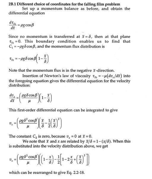

(their solution)
We are interested in getting the velocity profile.
I do not understand why they said at x=delta there is no momentum being transferred?is it because it is at the interface? how exactly is the fluid flowing?I want to understand the phenomena

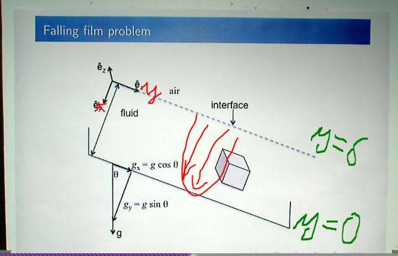

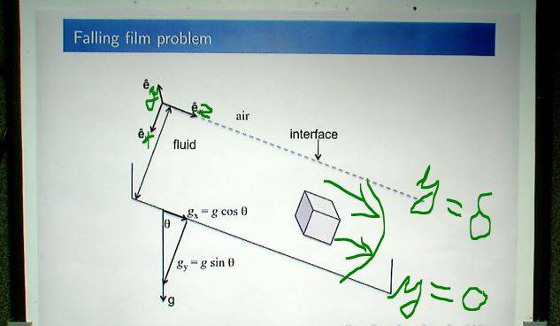

Below I am attaching 2 of my sketches, in the solution says that viscous force acting on x surface(which is perpendicular to the plane, and in the z direction). How did they knew that?
Which of the below sketches I made are correct, no1 or no2.
How can we deduce how is it flowing, given that he gave us the boundaries y=0 as the wall and y=delta as the gas-liquid interface?
I would really appreciate it if you could also provide me a better sketch, if mine are wrong.

The fluid is sliding down due to gravitational effect, no pressure is involved as P=Patm=0 at the interface.
I believe my sketch no1 is correct for this problem as the fluid is acting on the x surface(perpendicular to the plane) in the z direction(inclined).
Applying the boundary conditions we can conclude that the velocity=0 , near the wall where x(width of film)=0 .
At x=delta , there is no momentum generated due to the interface.

I hate developments in which they use the "momentum flux" approach. It drives me crazy, and the mathematics are very counter intuitive. So with your permission, I'm going to try how to illustrate how much simpler it is to do all this in terms of stresses and force balances. Would that be OK?
Meanwhile:
At the free surface, since air is on the other side of the interface, what is the normal stress that the air exerts on the fluid beneath the interface? Since the viscosity of air is so low, what do you think the shear stress is that the air exerts on the fluid beneath the interface?

It's more the low viscosity than the low density, but, in any event, the shear stress exerted by the air on the free surface is zero. (You are aware that the shear stress is equal to the viscosity times the velocity gradient, right?)
Remember that, from now on, we are going to work with shear stress rather than momentum flux, right? In your course, did they teach you that the momentum flux is equivalent to the shear stress? Stress is a so much easier concept to visualize than momentum flux because we can all relate to force per unit area.

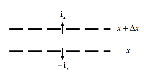

OK. I'd like to go to a simpler approach, but, before I do, there are some preliminaries I'd like to introduce.
Consider the figure below. It shows a slab of the fluid situated between planes of constant x, at ##x## and ##x+\Delta x##.
Also shown in the figure are two unit vectors, each pointing from inside the slab to outside the slab at its two boundaries. So at the top surface, the unit vector is pointing in the +x direction, and at the bottom surface, the unit vector is pointing in the - x direction.
Now I'm going to do something a little crazy. I am going to write down the following quantity: ##\tau_{zx}\mathbf{i_z}\mathbf{i_x}##. Note that it is z-x component of the stress tensor multiplied by two unit vectors, one in the z direction and the other in the x direction, respectively. Note that there is no mathematical operation (such as the cross product or the dot product) implied between the two unit vectors. So, as it stands, this expression has no obvious physical meaning. But look what happens when we dot this quantity with a unit vector in the +x direction (pointing out of the slab) in the following way:
$$(\tau_{zx}\mathbf{i_z}\mathbf{i_x})\centerdot \mathbf{i_x}=\tau_{zx}\mathbf{i_z}(\mathbf{i_x}\centerdot \mathbf{i_x})=+\tau_{zx}\mathbf{i_z}$$This is the shear stress that the fluid within the slab exerts on the fluid above it (including its correct direction). So, to get this stress, along with its correct direction, all we need to do is dot our crazy expression (involving the two juxtaposed unit vectors) with a unit vector pointing out of our slab. From Newton's 3rd law, the shear stress exerted by the fluid above the slab on the fluid within the slab is just ##-\tau_{zx}\mathbf{i_z}##.
Now, let's go to the bottom boundary and do the same thing, and see what we come up with. The unit vector pointing out of the slab at the bottom boundary of the slab is ##-\mathbf{i_x}##. Now, doing our new trick, we get: $$(\tau_{zx}\mathbf{i_z}\mathbf{i_x})\centerdot (\mathbf{-i_x})=\tau_{zx}\mathbf{i_z}(\mathbf{i_x}\centerdot (\mathbf{-i_x}))=-\tau_{zx}\mathbf{i_z}$$ This is the shear stress that the fluid within the slab exerts on the fluid below the bottom boundary (including its correct direction). So, to get this stress, along with its correct direction, all we need to do is again dot our crazy expression with a unit vector pointing out of our slab. From Newton's 3rd law, the shear stress exerted by the fluid below the slab on the fluid within the slab is just ##+\tau_{zx}\mathbf{i_z}##.
This is a foolproof way for getting the correct forces exerted by the fluid above and below the slab on the fluid within the slab, along with guaranteeing that the direction and sign of the forces are correct.
I'll stop here and let you digest this. Next will do a force balance on the slab in our problem, using this new trick to get the correct forces.
Questions?

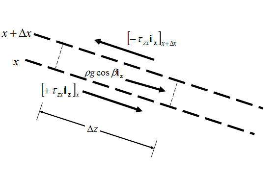

Free Body Diagram for Force Balance:
The figure above shows the force balance on a slab of the fluid between x and ##x+\Delta x##, and z and ##\Delta z##. This is the basic free body diagram. The equation for the force balance is $$\rho g \cos {\beta}\mathbf{i_z}\Delta z\Delta x+[\tau_{zx}\mathbf{i_z}]_{x}\Delta z-[\tau_{zx}\mathbf{i_z}]_{x+\Delta x}\Delta z=0$$Dividing this equation by ##\Delta x\Delta z##, taking the limit of the resulting equation as ##\Delta x## approaches zero, and dotting the resulting equation with ##\mathbf{i_z}## yields: $$\frac{d\tau_{zx}}{dx}=\rho g \cos \beta$$
How does this work for you?
