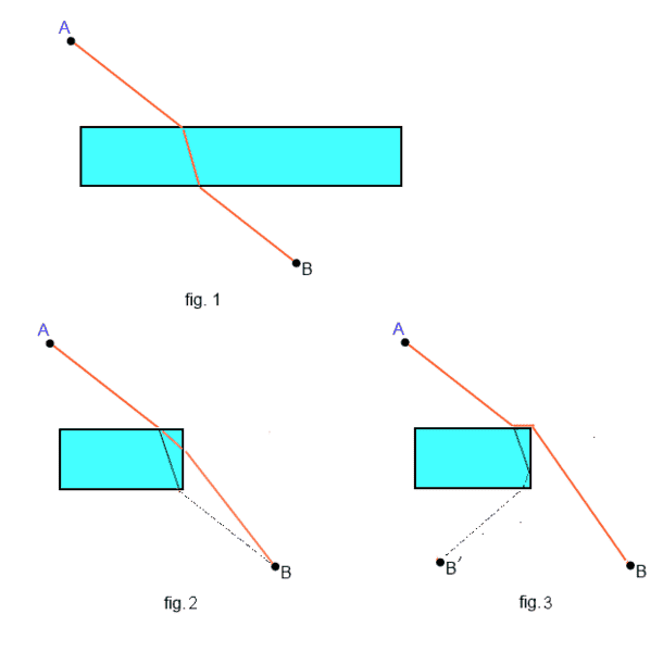

Is it working in special cases like this too?
Let's examine the fig. 1-3 below.
Fig1. is the normal case, the light goes from A to B and finds the "least time" path through the object.
Question 1:
What if we cut the object (Fig. 2), resulting a possible better path with less time? Will the light go unchanged, and arrives to the B as the dotted line shows, or will it find the less-time-path, even if this means that it must go through the object in a different angle?
Question 2:
What happens if we cut the object even shorter (Fig. 3), crossing the path of the ray goes normally through the object? Let's assume that in this case the "least time" path is if the light does not enter the object, but goes on the surface. Is this possible, and the path will be the orange one? Or in this case the light will do something else, like the reflecion inside, and will reach the B' ?
My question in general:
Is the "least time between two points" principle is an always working principle (rule 1), or the light is "not so smart" and can decide only locally on the entering points and can't "think further" (rule 2).
If the "rule 2" is the real one, why QP says that the light take all the possible paths?
Thank you!
no, it will always be quicker for the light to go through the glass, very near the corner …
check it and see! :wink:
Ok, tiny-tim, I see that on he corner it will enter into the glass, but on a small part of the path it will follow the surface, right? Of course only if this is the case of the principle is working "in general", which was my main question.
May I understand your answer that you are sure that the principle working "in general", so the light is "smart" and "knows" that the glass will end soon and will choose a different, "unusual" angle (fig 2)?
This behavior surely different to the explanations of the "general physics", that is about the substance property and the refractive index, this is why I think that this topic is about the Quantum Physics. This behavior explained by the QF and the calculation result of the all possible paths, am I right?
Unfortunately I have not found answers for my special cases on the Internet, I have found only explanations and examples of the cases where the "least time" principle resulted the same as the "refractive index" calculations. It would be nice if someone shows me a link where I can find an explanation on the net that shows an example where these two are different.
Please strenghten my tought that in case of the specially cut object (fig2 and fig3) the light will choose a different way and is able "to see before its path" and find always the least time path.
Thank you!

...and what about the fig 2? Is the orange path possible? Is it possible that the light goes through in a different angle than in the fig 1?

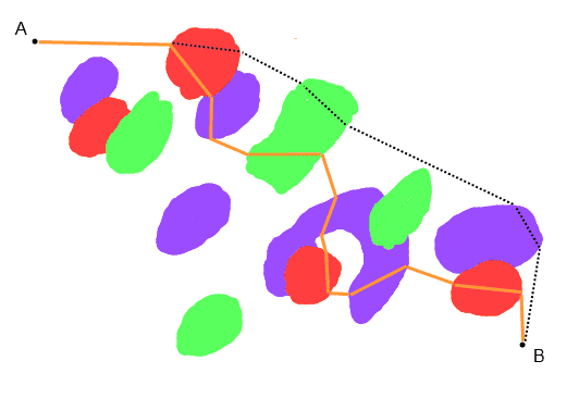

Let's see this figure:
Between A and B there are several objects with different refraction indexes. As you can see that this is some kind of a maze.
Let's shot a light ray from the point 'A' to a random direction and examine where it will go...
Let's try to calculate the path by the simple way: when we reach an object, calculate the new angle by the refraction index, and step forward. The orange line shows this path.
Now let's calculate the all of the possible paths and let's select the "least time" one. The dotted line represents this solution.
I think that if the task is to find the least time path throught this labyrinth, we can't succeed easily, only by following the refraction index rule. We need much more work to find the way with the shortest time.
Am I right or wrong?
The paths you drew through that coloured maze were not calculated, were they? You just made them up, I think.
Of course the image is only a demo, not based on calculation.

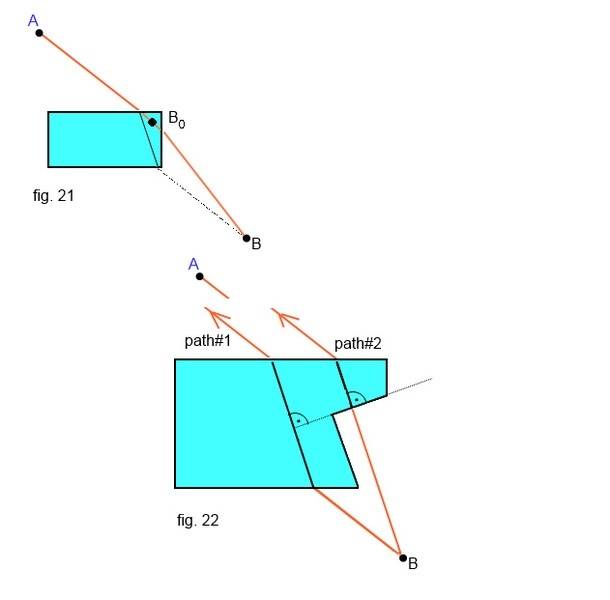

Here is an example, shows that the Fermat is better than Snell.
https://www.physicsforums.com/attachments/58104
(The fig. 21 shows that I assumed that the orange path is not available, since in the point B0 the path is not "least time optimal". But I changed my mind, this would be not relevant, only the final result counts: in the point B we measured the light ray, so it must be optimal to that point and irrelevant if during the path there are "seemingly not optimal" points)
Let's see the fig. 22.
To make it simple, the A is far in the infinity.
If we are not counting with the strangely cut part, the path#1 is the correct one, fits to Snell's law.
But if you take a look at the path#2, you can see that it is the least time path (and still fits to Snell!).
Am I right that the ray of light will go in the path#2?

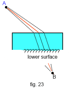

I understand now (still not completely clear for me however), that in the fig.21 the orange path is not availabe, and in the fig. 22 the ray will choose both the path#1 and #2 (in the point B we will see the point A in both directions)
Now I'll try to not assume something, only asking.
My question is:
Is there a shape available that by changing the lower surface of it, will change the entrance point of light ray? (And the light will still go from A to B) (Any kind of complexity is allowed, even mirrors or meta-materials, the only restriction is that the first, entrance surface must be untouched and flat)
See fig. 23.
good question. The best way to think about it is by thinking about the functional derivative, since this is the thing that must equal zero for any path [itex]y_{(x)}[/itex] that the light is allowed to take. The functional derivative is defined as this:
[tex]\frac{T[y_{(x)}+ \epsilon \phi_{(x)}] - T[y_{(x)}]}{\epsilon} [/tex]
In the limit as epsilon goes to zero, and T is the total time (a functional), and phi is an arbitrary function of x. So this is the lowest order change to the total time.
So how does this answer your question? Well, in the original case where the lower surface is flat, we know the single answer that gives an extreme path y(x). And if we change the lower surface? We still have the possibility of the entrance point of the light ray being in the same place. After, all, up until the lower surface, it definitely gives an extreme value for the total time up until then. So as long as we can find a continuation of this path that still is extreme, then the original entrance point of the light ray is still allowed.
But now since we have changed the lower surface, there is also the possibility of other extreme paths, since the geometry of the problem is not as simple anymore. In the original case, we knew there was a unique answer because the geometry was simple, but now it is not so simple, we can't say there is a single path that the light will take.
Also, we might change the lower surface such that the original path cannot be continued on an extreme path. (For example, we might even put an opaque object on the lower surface where the original path would have been, so the original path is not even allowed, let alone an extreme path). And we can make other changes to the lower surface, so that a different extreme path is possible. Light will take this path, and so in this sense, we can change the entrance point of the light ray by changing the lower surface.
One last thing, this post was a bit long because your question "Is there a shape available that by changing the lower surface of it, will change the entrance point of light ray?" Doesn't really have a direct answer, because your question implies that there is only one path. Light will take any and all paths which extremise the total time. So there is not just one possible path that we are changing. We solve for the functional derivative to be equal to zero, and all the solutions give the paths that light will take.

BruceW said:
... And we can make other changes to the lower surface, so that a different extreme path is possible. Light will take this path, and so in this sense, we can change the entrance point of the light ray by changing the lower surface.
Am I understand it right, that still the new path with the new entrance point have to fit to Snell's law? (I'll try to draw a concrete example with a new image that shows the old and the new lower surface/path, but I'm not sure that I can do it easily, if you have an idea, please help me on this too, thank you)
BruceW said:
... your question implies that there is only one path. Light will take any and all paths which extremise the total time. So there is not just one possible path that we are changing. We solve for the functional derivative to be equal to zero, and all the solutions give the paths that light will take.
Now I'll try to analyze your words and draw some (maybe wrong) conclusions (my imagination added). Please correct me...
1. In case of the simple rectangle (cuboid) the light path from A to B is clear, can be calculated easily by Snell's law and is the result of Fermat's principle, but it does not really matter, because that path is not much more real than the other possible paths...
2. ... because we can't be sure wether the light (package) is behaving as a wave or particle ...
3. ... but if there is a detector at the point B which determines the photon itself and its arriving angle, then we can calculate back and can determine the entering point into the surface ...
4. ... which is also not relevant, only a imaginary property, since the light itself interacted only in the point B, so nothing is changed at the entering point.
5. If we change the lower surface, the arriving angle may change and also the entering point -- that is not really matters, since the entering point is not a physical property. The light calculates and chooses, "knows" this imaginary path before it actually goes on it.
6. If we are thinking about the light as a particle, the light propagates not step by step, and decides its new angle when it hits the actual surface, but its path determined before its movement.
Am I too dreamy?
Yes. Good question. As long as we are assuming that the 'ray approximation' works, then at a sharp boundary between two materials, Snell's law is always going to work. You can reason it like this: we can always 'zoom in' on a bit of the path where the light ray crosses the boundary, so in this small section of space, there is simply a flat boundary between two materials. Now, if we change the path in this section by a small amount, then the first-order change to total time must be zero. So Snell's law must be obeyed at every boundary, even though there may be other stuff happening in other parts of the experiment. (again, this all assumes the 'ray approximation').
Am I too dreamy?
I don't know if you are dreamy, but I am not sure what you mean in several places. Also, you seem to dive right into quantum concepts, which you need to be a bit careful with, because the 'ray approximation' and the Feynman 'sum over paths' are quite analogous, but they are not exactly the same thing. The Feynman 'sum over paths' is an exact quantum calculation, and the 'ray approximation' is an approximate classical calculation.
1. Uh... I'm guessing you are talking about the quantum idea of how the photon's path is a superposition of all possible paths? In this case, there is only one path which leads to constructive interference, which is the 'classical' path corresponding to the 'ray approximation'.
5. Ah, not sure what you mean here. But the entrance point of the ray of light is a physical thing in this case. We are talking about the 'ray approximation', in other words, the path which corresponds to constructive interference. If we were talking about the actual path of a photon, then yes, this is not a physical thing, because the state vector is made up of a superposition of paths. But we are not talking about the path of a photon, we are talking about the path corresponding to a constructive interference.
edit: well, the entrance point is not really a physical thing.. I really meant that it can make sense using only classical physics. In other words, it is not something that we have to resort to quantum mechanics to explain.
