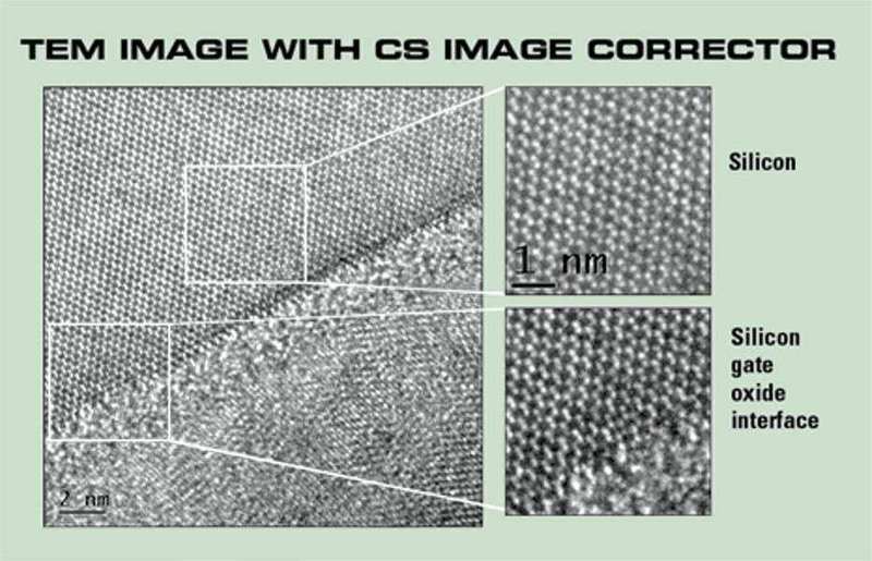

Well, it does looks like clouds when viewed with the brandnew highest
resolution electron microscope (resolution [itex]< 0.7 \AA[/itex])
http://www.reed-electronics.com/semiconductor/article/CA528449?pubdate=5/1/2005
It will be very interesting to see this technology progress further.
Regards, Hans
