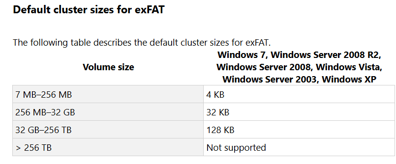

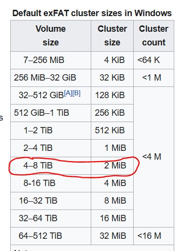

I just found out that the drive uses exFAT and according to Wikipedia, it should be using TWO megs for the cluster size (HORRORS !).
So it looks as though I'll just have to live with this.
I don't suppose partitioning it would be any help?
Interesting. The article (thanks by the way) points to THIS table, which says the cluster size should be 128K, not 1Meg
