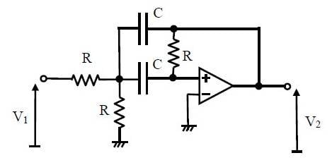

I need some help understanding how the phase shift was calculated in the following solved problem:
Shown below is an IGMF band-pass filter:
Its transfer function is given by: ##\frac{V_2}{V_1}=\frac{-\omega_0}{\sqrt{2}} \frac{s}{s^2+\sqrt{2} \omega_0 s + \omega_0^2}## where ##\omega_0 = \frac{\sqrt{2}}{RC}##
Calculate the gain (in dB) and phase shift of the filter at the corner frequency ##\omega_0##.
Solution:
##\frac{V_2}{V_1}(\omega_0) = - \frac{1}{RC} \frac{j \omega_0}{\sqrt{2} j \omega_0^2} = - \frac{-1}{RC} \frac{1}{\sqrt{2} \omega_0} = - \frac{1}{2}##
##\implies |\frac{V_2}{V_1} (\omega_0)| = 20 \log(1/2) = -6 \ dB##,
##phase |\frac{V_2}{V_1}(\omega_0)|= \pi##
So how did they work out the phase shift to be π?
What formula have they used to find the phase shift? :confused:
I couldn't find any notes in my coursebook on finding phase shift once you have the gain. Any help or explanation is greatly appreciated.

A pure inversion is a phase shift of 180°
For a bandass filter, ωo is normally referred to as the centre frequency, not the corner frequency.
But what equation did they use to get the 180° in this problem? I'm a bit confused... once we have the gain from the transfer function at a particular frequency, what formula do we use to find the phase shift?
Think about the difference between a gain of +1/2 and -1/2. One has the input and output in phase, the other has them 180° out of phase.

The formula in your first post in this thread shows a gain of -1/2. So which is it??
tan 180 = 0
tan 0 = 0
So you need to look at the sign of the real component to see which side of the x-axis it lies.

Thank you. Oops, sorry I meant -1/2. So basically every time the imaginary part is 0 and we have a negative or positive gain, the phase will be ##-180°## or ##180°## respectively? Is this right?
I'm still not 100% sure why the sign of gain determines the location of ##\phi## on the tangent graph.
No.
-180° and +180° are equivalent.
Negative gain at 0° is equivalent to positive gain with 180° phase shift. For a sinewave you'll see no difference between the two.
Likes 1 person
Using methods previously mentioned can get you the exact phase at any frequency. However there is an easy way to determine the approximately phases at different points.
A zero will always add a positive phase shift of 90 degrees.
A pole will always add a negative phase shift of 90 degrees.
The effect of the pole/zero on face begins 1 decade before the pole/zero, and ends 1 decade after the pole/zero.
if there is a pole/zero that is equal to zero, that is the phase of the system at DC.
So the circuit you posted has a zero at 0 and 2 poles at (1[itex]\pm[/itex]j)*wo/sqrt(2)
that means the phase will start at 90. It will begin breaking about 1 decade before wo, and end breaking 1 decade after wo. each pole will effect the phase by 90 degrees, the the phase will be -90 1 decade after the break point
Likes 1 person
