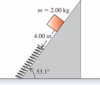

    A 2.00-kg package is released on a [tex]53.1 ^\circ[/tex] incline, 4.00 m from a long spring with force constant 120 N/m that is attached at the bottom of the incline. The coefficients of friction between the package and the incline are[tex] \mu_{s} \;=\; 0.40[/tex] and [tex]\mu_{k} \;=\; 0.20.[/tex] The mass of the spring is negligible.
    1. What is the speed of the package just before it reaches the spring?
    2. What is the maximum compression of the spring?
    3. The package rebounds back up the incline. How close does it get to its initial position?

    I started off by breaking the force of weight into x and y components. I used the equation [tex]K_1+U_1+W_f=K_2+U_2[/tex]. But, [tex]U_1=K_1=0[/tex]. I'm looking for the final velocity, which can be found in the final kinetic energy.
    My answer was 8.50 m / s, but that was incorrect.
    For the second problem, I used [tex]K\Delta X=f_k+mgsin(\Theta)[/tex]. Solving for [tex]\Delta X[/tex], I got .151 m, which is also incorrect.
    I don't know how to do part C.

    The idea of using energy methods is fine. Show exactly what you did.
    When the spring is maximally compressed the force on the package will not be zero. Once again, use energy methods.

    For part a, I did [tex]K_2+U_2=W_f[/tex].
    So, [tex](1/2)(2.00)(v_2)^2 + (2.00)(9.80)(-3.20) = -.47[/tex]
    [tex]v_2=7.89[/tex] m/s.
    But, that is also not correct.

    Show how you calculated the work done against friction.
  7. Oct 4, 2005 #6
    Yeah, something was SERIOUSLY not right with that work done by friction.
    I ended up getting the correct answer. I must have punched in something wrong in my calculator.
