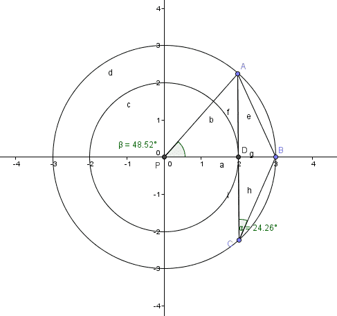

Hi Albert. Where is point $C$?
Since the problem implies (truthfully) that it does not matter where C or A is located up to the constraints (on circle), I picked AC to be vertical.
This depicts one of the Pythagorean Means, specifically the Geometric Mean.
That is to say; Length AD is the GM of DB and 6-DB. AD = SQRT(1*5).
AD=DC so AD*DC = 5
(proof of the implication not being required, makes this a simple problem)
AD=DC so AD*DC = 5
very good solution !
