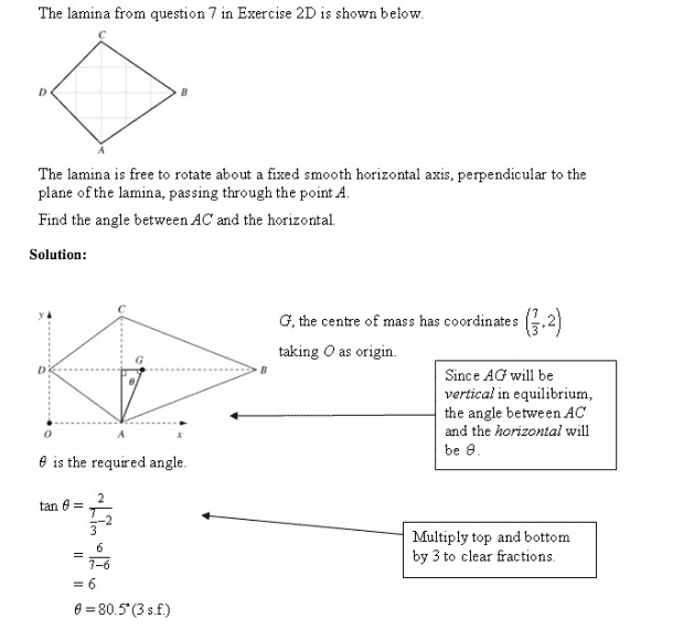

The lamina is free to rotate about a fixed smooth horizontal axis, perpendicular to the plane of the lamina, passing through the point A. and hangs in equilibrium.
Find the angle between AC and the horizontal.
I have attached a the solution to the question, it seems like there is no line to the question and theta there are showing in the working out.
I think the answer is 9.46 degree as tanφ= 1/6
.[/B]
I have attached screenshot to this thread. Is the solution wrong or have I been thinking in a wrong way? What are looking at that theta shown in the screenshot?
More like thinking upside down . If you were holding the lamina in the position shown what would happen when you let go of it ?
lamina will turn so the centre of mass is below the pivot.
That's it .
Likes Kajan thana
Nidum said:
That's it .
yes but my question why have they goy theata there when they ask for the theta between the horizontal and AC
Nidum said:
That's it .
i thought about it. It makes sense what they have done.
