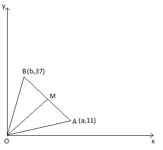

The points O,A and B are vertices of an equilateral triangle. Find a and b
O=(0,0)
A=(a,11)
B=(b,37)
##c^2=a^2+b^2##
Let AB =c
Then ##c=\sqrt{(a-b)^2+(11-37)^2}=\sqrt{(a-b)^2+676}##
Since it is an equilateral triangle, OA and OB is also =c
So ##c=\sqrt{11^2+a^2}##
##c=\sqrt{37^2+b^2}##
##\sqrt{(a-b)^2+676}=\sqrt{11^2+a^2}=\sqrt{37^2+b^2}##
I have got to know that ##a^2+b^2=1248##, but what next?
I need to find at least one variable to find the other. :confused:

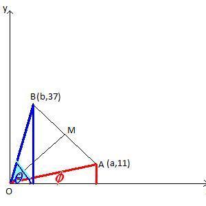

Very good. Look at the picture. You find two right triangles, the red one having angle Φ with the x axis, the blue one has angle θ. θ=60°+Φ.
If the sides of the equilateral triangle are of length C, C cos(θ)=b, C sin(θ)=37 Ccos(Φ)=a, Csin(Φ)=11
θ=60°+Φ, apply the addition laws. You know that cos60°=1/2, sin/°=√3/2.
Csin(60°+Φ)=Csin(60°)cos(Φ)+Ccos(60°)sin(Φ)→(√3/2)a+(1/2)11=37
Do the same with Ccos(θ):
C cos(60°+Φ)=Ccos(60°)cos(Φ)-Csin(60°)sin(Φ)→(1/2) a-(√3/2)11=b
Solve.

ehild said:
θ=60°+Φ
How do you know this?
EDIT: Oh I got it, How dumb I am !
This also yields a simultaneous equation right?
Anyway, thank you so much! I learned a lot from this thread. Thanks everyone!
