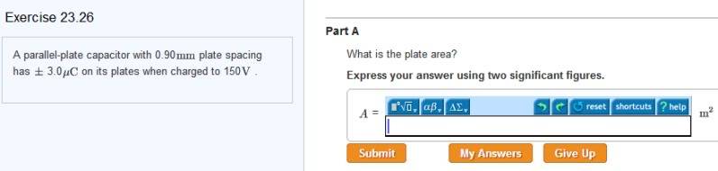

capacitance = charge/volt
capacitance = Esub0 (side of parallel plates^2)/(distance apart)
capacitance = (3*10^-6 C)/(150v)
capacitance = 2 * 10 ^ - 8 F
2 * 10 ^ - 8 F = (8.85 * 10 ^ -12)(side of parallel plate) ^ 2/(.90 *10^-2)
side of parallel plate is 20 m ^ 2.

Your distance value doesn't look right; check your units conversion. Since you're looking for the plate area anyways, why involve the square of the side length when you can solve directly for the area?
Fix your d value and try again. Make sure that your result description and units match (you reported a side length in square meters before).

oops milli is 10^ -3
i found my mistake. plate area = (capacitance)(distance)/(esub0)
plate area = (2*10^-8)(.90 * 10 ^-3)/ (8.85 * 10 ^ -12) = 2 m ^ 2 =]

Yup, that looks better :smile:
