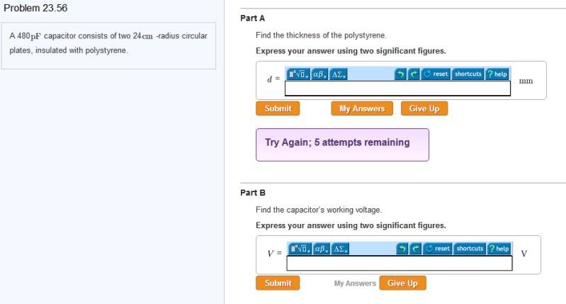

Capacitance = k(epsilon zero) (Area) / (distance)
Length (thickness) = (Volt)(Area) / (Current * Resistivity)
Given:
Capacitance : 480 * 10 ^ -12 Farad
Radius: 24 * 10 ^ - 2 m
Area: pi * r ^ 2
dielectric constant of polystyrene: 2.6
breakdown field(MV/m) : 25
Resistivity of Polystyrene : 10 ^ 15
distance = (2.6)(8.85 * 10 ^ -12) (3.14 * (24* 10 ^ -2) ^ 2) / (480 * 10 ^ -12)
however finding the distance does not seem to help me at all since the other equation do not involve distance
any guidance would help
Hello. What distance does this represent physically?
distance apart for two capacitors
I guess you mean the distance between the two circular plates of the capacitor. (You only have one capacitor.)
But isn't this the same as the thickness of the polystyrene?
oh so that's what they mean! now that I think about you have a point there. so length, spacing, distance,thickness are same ideas. thanks for the guidance
Yes. It's always important to know what the symbols in an equation represent.

It's a capacitor; you do not want current.
What do you take the term 'breakdown voltage' to mean?

well i did list the polystyrene breakdown field to be 25 * 10 ^ 6 V/m
oh now I get it! multiply the thickness by the breakdown voltage and viola working voltage. thanks haruspex!

But what specifically in relation to capacitors?
Yes, but you did not use it.
I know the electric field = (Volt)/(Area)
So what would the breakdown voltage be for this capacitor?

No, it would be the capacitor passing a DC current, which it is not supposed to do.
I just wind up using the answer I got for thickness and used it with the breakdown voltage and found voltage that way.
Let's get the terminology right: you used the breakdown field and the polystyrene thickness to find the breakdown voltage, which is the 'working voltage' required, yes?
