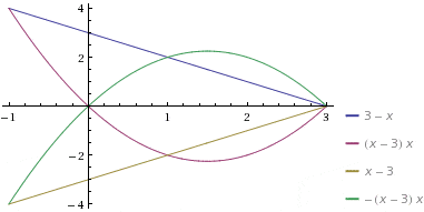

The following is a graph by WolframAlpha which may help for the rotation about the x axis.
It's a graph of 4 curves:
[itex]y = -x + 3[/itex]
[itex]y = -(-x + 3)[/itex]
[itex]y = x^2 - 3x[/itex]
[itex]y = -(x^2 - 3x)[/itex]

I did try this way...I find the region at the interval [-1, 0] by take the integrate of pi ∫(-x+3)^2 - (x^2 - 3x)^2 dx...
Then, pi x ∫ (-x+3)^2 - (-x^2 + 3x)^2 dx for interval [0,1]
Then, pi x ∫ (3x-x^2)^2 for the interval [1,3]
and take the sum of all...and get 56pi/3
but the answer is not that
This one is incorrect.
Added in Edit:
For x > 0, the inner radius is zero. -- This becomes the disc method rather than the washer method for x > 0.
I'll modify my previous suggestion. If you treat overlapping and non-overlapping entirely separately you'll have five separate integrals (2 for overlap, 3 for non).
It's a bit easier to process the whole shape without worrying about the overlap, then subtract the overlap parts on the basis that they have been counted twice. That should reduce it to the three integration steps.
