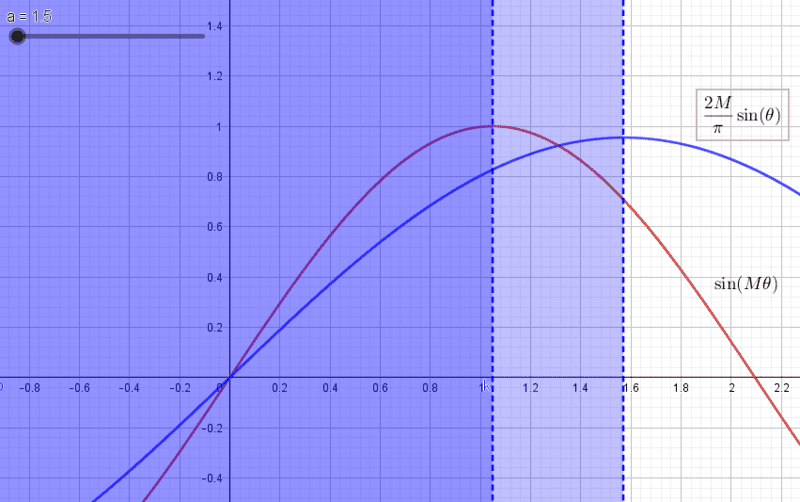

To see that there is a single zero of ##f'(\theta)## I took out the factor of ##M## and looked at the graphs of the two components. This can be made rigorous with a little more calculus.

There's nothing mysterious. We have two monotonic functions that must intersect once and only once on the interval ##(0, \frac{\pi}{2M})##.
You had said before that you pulled out the ##M##. So we look at these two functions ##f_1(\theta) = \cos(M\theta)## and ##f_2(\theta) = \frac{2}{\pi}\cos(\theta)## and find that they intersect somewhere in the interval from ##0## to ##\frac{\pi}{2M}##.
Yes, exactly. Looking at the graphs: The first starts at ##1## and decreases to ##0##, the second starts at ##\frac 2 {\pi}##, which is less than ##1## and decreases to some positive value at ##\theta = \frac{\pi}{2M}##. That gives one point of intersection.
Likes Peter_Newman
