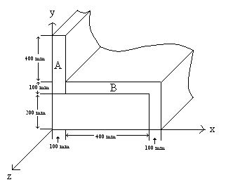

In summary, the problem involves finding the coordinate (x,y) of the center of mass of an object with two parts, A and B, with densities of p (kg/m^3) and p/2 (kg/m^3) respectively. The object has a length of one meter in the z direction. To solve this problem, it is suggested to break it down into three rectangles, calculate the mass and center of mass of each, and then find the overall center of mass of the object. This is a 2D problem, not a 3D one, and the solution can be found by considering the three masses as point masses at their respective centers of mass.
xxlvh
1. The density of part A (p)(kg/m^3) and in part B (p/2)(kg/m^3). Find the coordinate (x,y) of the center of mass of this object.
(consider a piece of the object that is one meter in the z direction)
2. R = sum(m*r) / sum(m)...maybe? I am completely stumped on how to start this problem my teacher has done no sample problems that are anything like this, not even anything in 3D, if anyone could at least provide a hint to get me started on this one? Would be greatly appreciated.
This isn't a 3d problem, it's a 2d problem and he only wants [itex](\overline x,\overline y)[/itex] Break it up into three rectangles, find the mass and center of mass of each. Then find the center of mass of the three masses as if they were point masses at their centers of mass.
