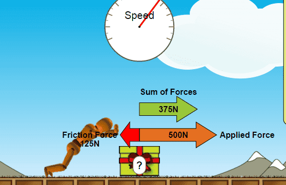

Well its on a friction simulator online. I'm pushing on a unknown mass with 500N of applied force. The friction force comes out as 125N and the sum of the forces is 375N to the right direction. I am asked to find the mass and the weight of the object. I want to know the mass of the object which in turn will let me work out the weight with W=mg.

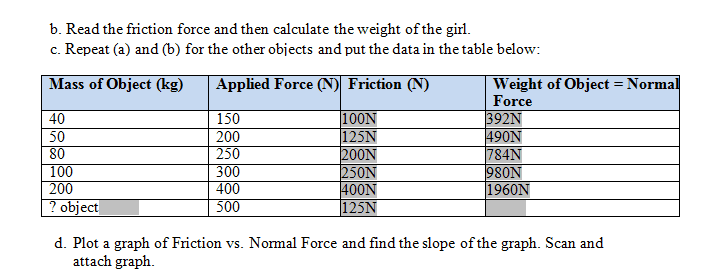

I do not see that enough information has been given to solve the problem. Does the diagram or chart have any other info in it? Or a previous problem?
Am i allowed to attach a picture of the chart and also the picture of the simulator??
Go ahead.
So you have plenty of other info! Hint: Use the data for the other masses to figure out the coefficient of friction. (In fact, if you understand the chart, you don't even need to calculate the coefficient. You can just read off the mass that you need.)

Pick one of the masses that are given. Find the normal force, which is just the weight. You are given the friction force. Use those values to calculate the coefficient.
Once you have the coefficient, you can use it with the friction force to calculate the unknown mass.
