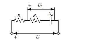

In the network of sinusoidal current , R2 = 10 ohm , X2 = -30*sqrt(3) ohm. Find the resistance R1 so that voltage U2 is in phase delay behind voltage U for angle alpha = - pi / 6.
