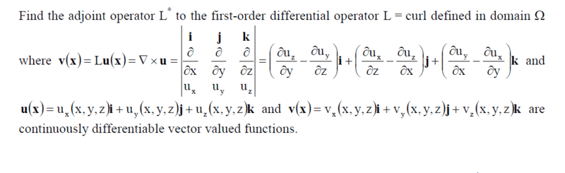

Find the adjoint operator L* to the first order differential operator L = curl defined to domain omega. The full problem is attached.
I've checked online. I am getting two different answers. Is the solution the conjugate transpose or the adjugate matrix?

Adjoint is defined relative to inner product. What is your inner product? I.e. your operator operates on some functions. What is the inner product of these functions? Also, what is domain ##\Omega##?
The inner product would be:
∫u(x)*v(x) dx from -∞<Ω<∞
In your scan I can see things being differentiated with respect to ##x, y, z## so how come your inner product is for functions of just one variable?

Your operator is curl ##\mathbf{L}=\mathbf{\nabla}\times.##. It acts on vector-valued functions. In your scan it is also shown that operator acts on functions of ##x,y, z##. So I would expect your functions, on which ##\mathbf{L}## acts, to be ##\mathbf{u}\left(\mathbf{r}\right)=\mathbf{u}\left(x, y, z\right)##, i.e. functions that take a position vector (##\mathbf{r}##) in, and give your some other vector (##\left(u_x, u_y, u_z\right)^T##) out.
Suitable candidate for the inner product is then:
##\langle \mathbf{u} | \mathbf{v}\rangle = \int d^3 r \, \mathbf{u}\left(\mathbf{r}\right)^{\dagger}.\mathbf{v}\left(\mathbf{r}\right)##,
but this is not the only candidate. Also, I am slightly worried by the fact that your domain is ##\Omega##. Often ##\Omega## means solid angle, which would suggest
##\langle \mathbf{u} | \mathbf{v}\rangle = \oint_\Omega d^2 \mathbf{\hat{r}} \, \mathbf{u}\left(\mathbf{r}\right)^{\dagger}.\mathbf{v}\left(\mathbf{r}\right)##
So how about defining the problem in a way that one does not have to guess?

Lets assume the first guess is correct. The inner product is ##\langle \mathbf{u} | \mathbf{v}\rangle = \int d^3 r \, \mathbf{u}\left(\mathbf{r}\right)^{\dagger}.\mathbf{v}\left(\mathbf{r}\right)##
The adjoint of ##\mathbf{L}##, which we shall denote ##\mathbf{L}^\dagger##, is defined by:
##\langle \mathbf{u} | \mathbf{L}\mathbf{v}\rangle=\langle\mathbf{L}^\dagger \mathbf{u} | \mathbf{v}\rangle##.
Integrating by parts (assuming ##\mathbf{u}\, \mathbf{v}## vanish at infinity):
##\langle \mathbf{u} | \mathbf{L}\mathbf{v}\rangle =\int d^3 r \, \mathbf{u}_\alpha^{\dagger}.\epsilon_{\alpha\beta\gamma}\partial_\beta\mathbf{v}_\gamma=-\epsilon_{\alpha\beta\gamma}\int d^3 r \, \partial_\beta \left(\mathbf{u}_\alpha^{\dagger}\right).\mathbf{v}_\gamma=\int d^3 r \, \epsilon_{\gamma\beta\alpha}\partial_\beta \left(\mathbf{u}_\alpha^{\dagger}\right).\mathbf{v}_\gamma=\int d^3 r \, \left(\mathbf{\nabla}\times\mathbf{u}^{\dagger}\right).\mathbf{v}=\langle \mathbf{L} \mathbf{u} | \mathbf{v}\rangle##
i.e. ##\mathbf{L}## is self-adjoint (for this inner product), so ##\mathbf{L}^\dagger=\mathbf{L}##. Above ##\epsilon_{\gamma\beta\alpha}## is the Levi-Civita (relative) tensor, and index repitition implies summation. If you are not confident with this notation, try doing integration by parts for all components of your operator independently, i.e. start with
##\langle \mathbf{u}_x | L_x\mathbf{v}\rangle + \langle \mathbf{u}_y | L_y\mathbf{v}\rangle + \langle \mathbf{u}_z | L_z\mathbf{v}\rangle =\int d^3 r \, u_x^{\dagger}.\left(\partial_y v_z - \partial_z v_y\right) + \dots = -\int d^3 r \, \partial_y u_x^{\dagger}.v_z + \int d^3 r \, \partial_z u_x^{\dagger}.v_y + \dots##

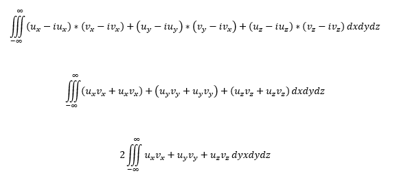

OK, so I have:
2∫∫∫dxdydz (uxvx)+(uyvy)+(uzvz)
I cannot guess what you started with. Please provide your starting conditions, intermediate steps and result if you want me to check this. Also, please do so in LaTeX form, as did I, it makes it much easier to read.
I can't seem to upload the images by copy and paste.
When I get to the third line, I am unsure how to proceed. If I integrate with respect to x the first term becomes uv but what about the other two terms?

I don't understand. Why are you trying to integrate unknown functions ##u,v## (also you seem to have dropped my superscripts ##\dots^{(r,i)}## for some reason)? The aim, I thought, was to use integration by parts to find the adjoint of the curl-operator. You seem to be quite lost. Maybe it is better to drop the complicated 3d case, and go back to basics.
Consider one-dimensional functions, e.g. ##u=u\left(x\right)##, and operator ##p=\frac{d}{dx}##. Let the inner product of two functions be:
##\langle u | v \rangle=\int_{-\infty}^\infty dx\, u\left(x\right)^* v\left(x\right) ##, here ##\dots^*## denotes complex conjugation
Can you find the adjoint of ##p##? i.e. can you find ##p^{\dagger}## such that
##\langle p^\dagger u | v \rangle = \int dx\, p^\dagger u\left(x\right)^* v\left(x\right)=\langle u | p v \rangle = \int dx\, u\left(x\right)^* p v\left(x\right) = \int dx\, u\left(x\right)^* \frac{d v}{d x}\left(x\right)##
Assume all functions vanish as ##x\to\pm \infty## and use integration by parts (https://en.wikipedia.org/wiki/Integration_by_parts)
