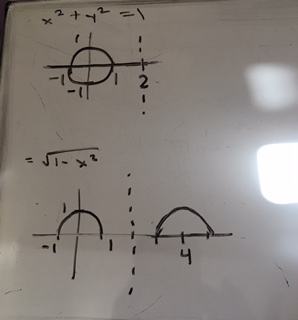

Finding the volume of a Torus
In summary: I think I made a mistake, it shouldn't be p(y) or h(y), but p(x) and h(x). Also, I think I will understand it with a visual so I tried drawing the graph. The graph at the very top of the image is the torus. The graph below shows a semicircle rotating about the x-axis. A torus has two radii so I would need to insert another integral. The width of a semicircle is ##\sqrt{1-x^2}##. So the equation becomes Volume=2\pi\int_a^b p(x)h(x)dx.
Jovy
A torus is formed by revolving the region bounded by the circle ##x^2+ y^2= 1## about the line x =2 Find the volume of this “doughnut-shaped” solid.
(Hint: The integral ##{\int_{-1}^1} \sqrt{1 -x^2} dx## represents the area of a semicircle.)
2. Homework Equations
$$Volume=2\pi\int_a^b p(y)h(y)dy$$
[/B]
I know that h(y) or the width is ##\sqrt{1 -x^2}##
The radius or p(y) is (2-x).
However, when I plug that into the equation and integrate, I get 0 and I know that's wrong.

I think I made a mistake, it shouldn't be p(y) or h(y), but p(x) and h(x). Also, I think I will understand it with a visual so I tried drawing the graph. The graph at the very top of the image is the torus. The graph below shows a semicircle rotating about the x-axis. A torus has two radii so I would need to insert another integral. The width of a semicircle is ##\sqrt{1-x^2}##. So the equation would look something like this, ##Volume=(something~\pi)\int_{-1}^1 p(x)\sqrt{1-x^2}dx-(some~number~\pi)\int_{-1}^1 p(x)\sqrt{1-x^2}dx##. Because it is a torus, the equation wouldn't have ##2\pi##, I don't necessarily understand why, I just know it's not ##2\pi##.
I do apologize, I bet this is becoming quite tedious, I just still don't understand how to find the two radii. When looking for the radius, do I just look at the part of the graph that is rotated. For example, in my image, would I look at the semicircle on the right of x=2?

You are responding to what @haruspex asked in post #10. So why not answer his question?
No, it does need to be as functions of y. They represent two different widths. One is the width of the lamina being rotated (in this case a circle), measured at height y from the x axis. I believe this is what h(y) represents in your formula.
The other is a bit harder to describe.
Consider a thin horizontal slice at height y through the lamina. This has a (horizontal) midpoint. When the lamina is rotated about the axis, that midpoint moves around in a horizontal circle about that axis. That circle has a radius, represented in your formula by p(y).
Now, rather than just learning how to use the formula correctly, it would help you greatly if you were to understand why the formula is correct.
Suppose the horizontal slice has thickness dy. Rotating it about the axis produces a horizontal annulus. The circular hole in the centre has radius p(y)-h(y)/2, while the outer radius of the annulus is p(y)+h(y)/2. (Draw yourself a diagram to check this.). The area of the annulus is therefore π((p+h/2)2-(p-h/2)2)=2πph.
Since the thickness of the annulus is dy, its volume is 2πph.dy. Integrating that gives the volume of rotation.
Note that this works for any lamina rotated around an axis outside of itself and parallel to the y axis. (If the axis of rotation were parallel to the x-axis then you would want p(x)h(x).) In the case of the torus, p(y) turns out to be constant.
