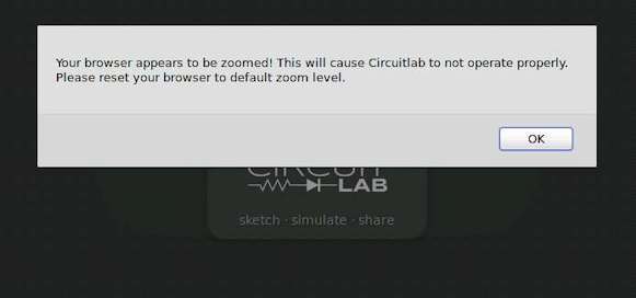

In future could you post schematics as a picture, e.g., a jpeg. It should be possible for you to take a screenshot of the circuitlab screen and post that jpeg. A picture loads much faster and this will overcome some readers not being able to see your schematic:
